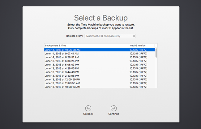

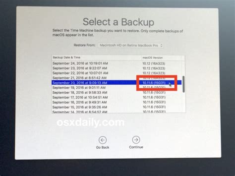

Yes to both #1 and #2. TM has full admin rights to backup everything, including the OS.
You would just option key boot to the TM disk then erase the internal disk and restore. During the restore process you will get a screen like this. Just scroll down (back in time) until you get the OS version you want and restore.
Reactions: tevion5 and HDFan

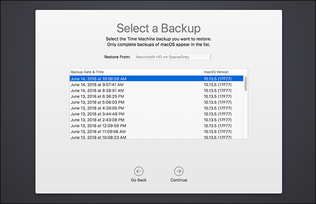

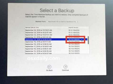

Yes to everything you said assuming you have a large enough hard drive to hold data going back that far. If you option key boot to the TM drive and select restore you will get a screen similar to this one where you can pick what date/OS version you want to restore from.
The only issue is say you installed High Sierra Oct. 1, then Dec. 1 decide to restore back to Yosemite... that will work fine, but the restore would not include any changes or data from between those two dates since you are restoring to a point back in time at Oct. 1.
