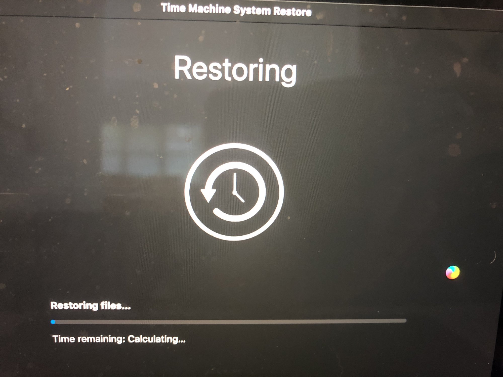

Hi everyone. I am having a time machine issue. I am attempting to restore from backup. I started the computer in restore mode located the backup (two days old) and proceeded to select restore. My computer screen shows the “time machine system restore” screen, says it’s “restoring,” and it then Says “restoring files … time remaining calculating.” For many hours now I have also been getting a spinning pinwheel. And no progress appears to be being made. Photo attached.
Should I be letting this play out or is this hung and so I need to hard restart and deal with the fallout?

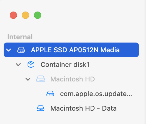

Starting with Catalina, and including Big Sur, the main drive is divided into two volumes. One OS volume and a Data volume. You can see it in my screenshot here.
High Sierra does not use that setup, so I don't think you will be able to restore a High Sierra install to a drive that was converted like this for a Big Sur install.
Did you boot to Internet recovery first then erase the whole drive before you started. I believe that will be the key here.

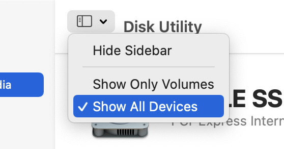

Yep... just shut her down and restart while holding command-option-r. After entering your wifi into you should see a spinning grey globe while the recovery utility downloads. Once the utility starts, launch Disk Utility tell it to Show all devices. That way you can see the drive itself at the top and not just the volume(s).
Now select the drive itself at the top like where it says Apple SSD in my earlier screenshot. Now click erase and format the whole drive to one MacOS Extended (Journaled) volume. Then quit Disk Util and click restore. Point the restore source to your Time Machine drive and go back like you did earlier to the older High Sierra backup to restore from.
