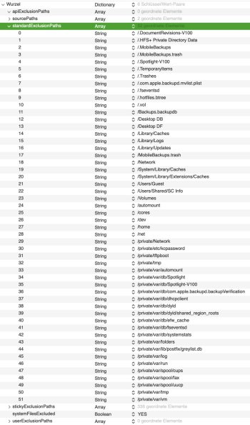

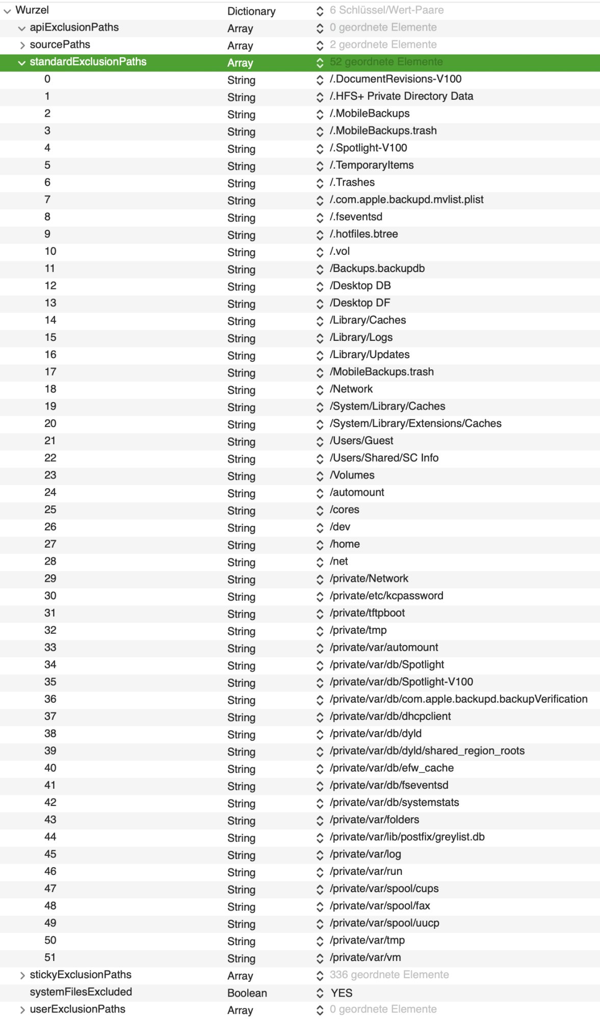

On your TM backup drive, in the backup itself, there is a (hidden) file named ".exclusions.plist" which contains all excluded folders/files. The list in my case (52 + 336 locations) seems larger than what CCC excludes.
So given the age of your system, maybe TM knows better, what can additionally be excluded.
Just a guess but it does at least not seem implausible.
