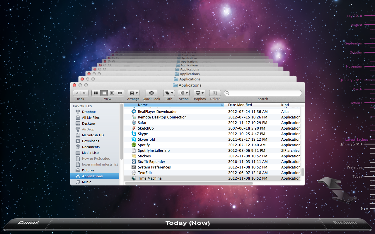

When I click on Time Machine, I just get a space-image with multiple Finder windows on top of one another.
I don't get anything that actually lets me select anything.
I think it used to really clearly just give me an option of backing up.
Can anyone tell me how to fix it?
This should hopefully be a screenshot
It looks to me like it says my last backup was Oct 2011 (ah!)

In restore mode. How to get out of mode?
I looked at that, but still can't figure it out...
I don't want to restore what was on my external hard drive.
I want it to start backing up what's on my laptop (so I want it to come out of restore mode)
How do I do that?
Appreciate all suggestions
