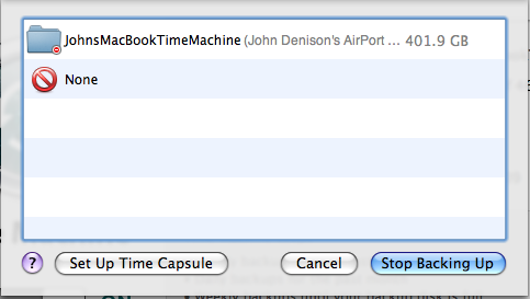

The AEBS has managed to loose the disk attached to it. When I tried to reconnect the disk selection dialogue box showed a not entry sign has my screen shot shows then I little later it gave the following message:

I then tried to open the sparse bundle image and got a message saying it was unavailable. It could be corrupted?
From my experience it appears that I will have to wait over two whole days to get the initial back done with high risk of the AEBS loosing connection and bug***ing the whole thing up. This was this feature that I paid for. I tried to create a sparse bundle image with the correct name but it didn't show up in the disk selection box.
