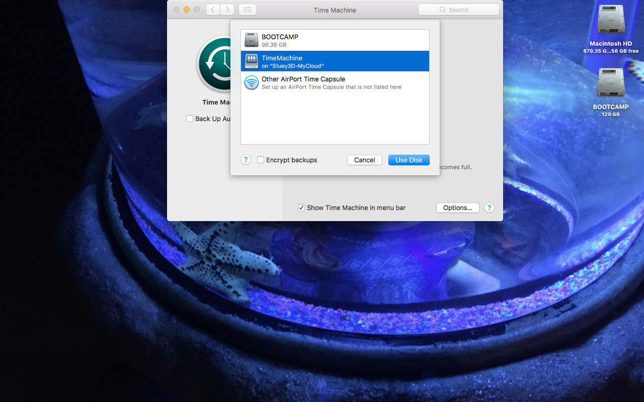

[doublepost=1469131131][/doublepost] Screen Shot 2016-07-21 at 20.57.06.png
Also it still sees the drive the problems come when trying to connect to it to use it.

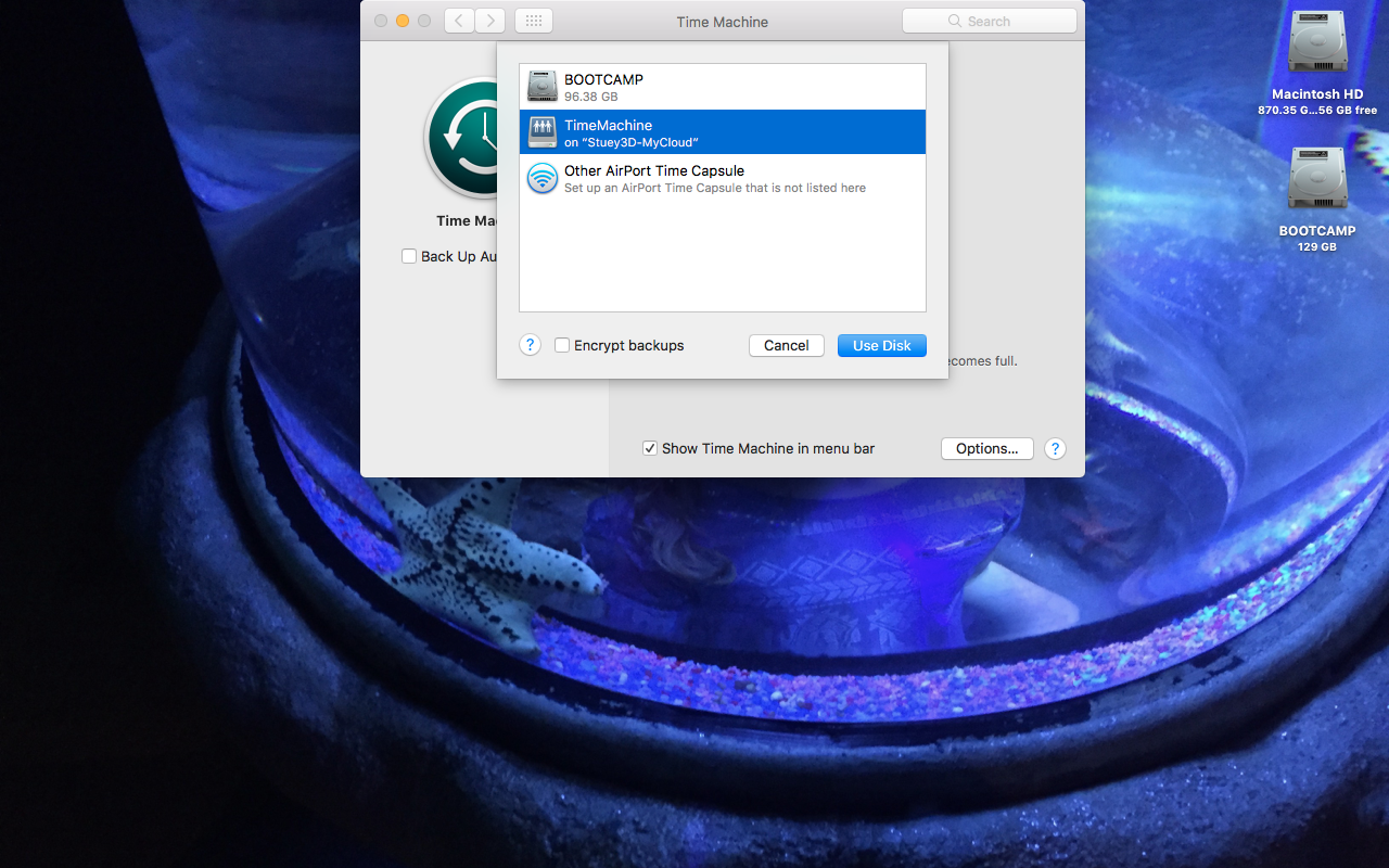

[doublepost=1469131131][/doublepost]View attachment 641247
I agree. It sees the drive not an issue as I can mount folders. The issue seems to be when it try's to connect, MacOS doesn't bring up the username/password dialog.
