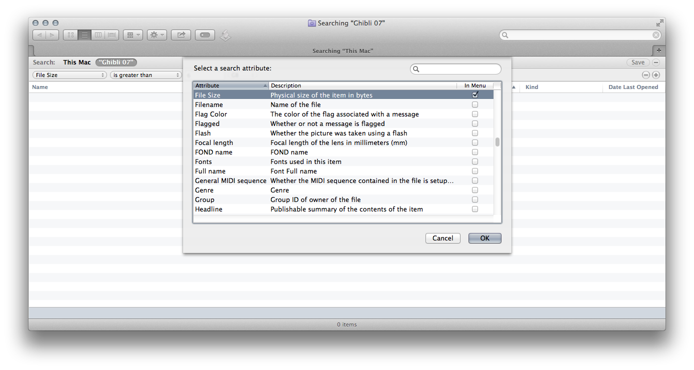

No outlook, no vm. Maybe a db file (eg postgres or MySQL), but how would you go about sniffing out the culprit?

If you do not have a VM, it is probably that it is a database file. Do you use other backup programs or an online sync program (CCC, Dropbox, Carbonite, etc.)? Programs like these use databases to maintain a file list and the database can become fairly large at certain times, usually while the program is in process. If you use a program like this, search for its DB file and try excluding it from the Time Machine backup and see if that makes a difference.
