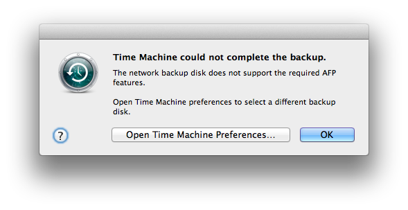

Thanks for your reply! Unfortunately I have tried the steps you mentioned already and I tried them again after your post but no success. I have tried this with two different hard drives.
I really don't know what's wrong. I found out a way for Time Machine to show unsupported drives via Terminal but backing up never works. All I get is this error message:
content
I have no clue why. Both are just normal external hard drives. One connected via USB and the other uses FireWire 800.
