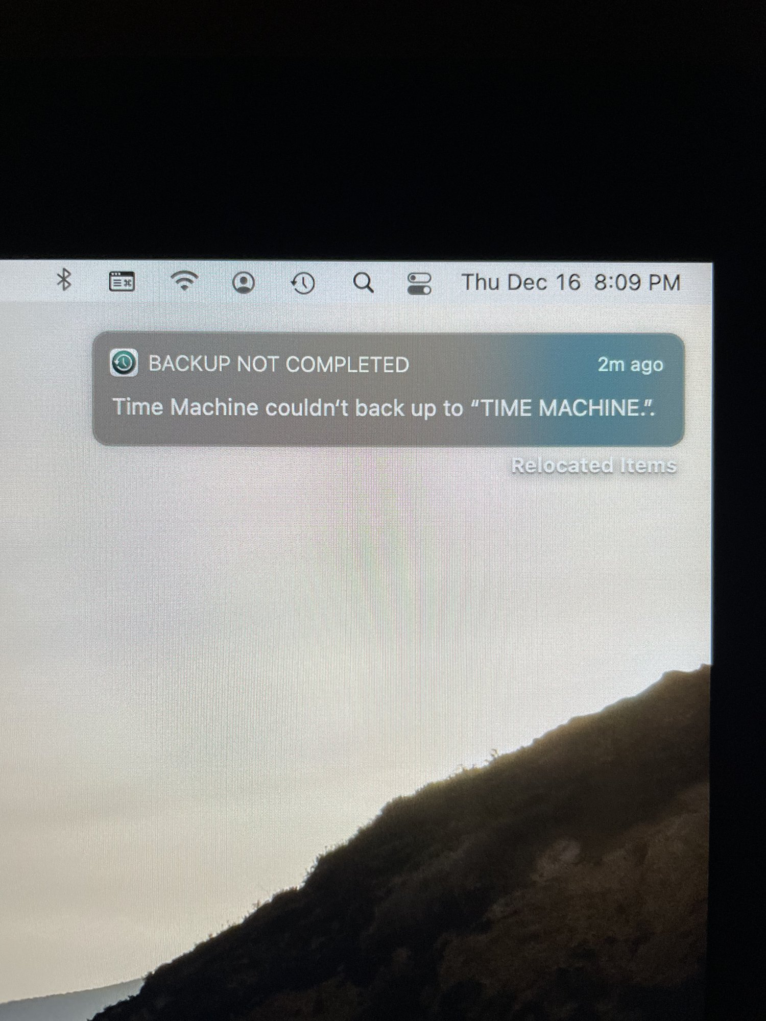

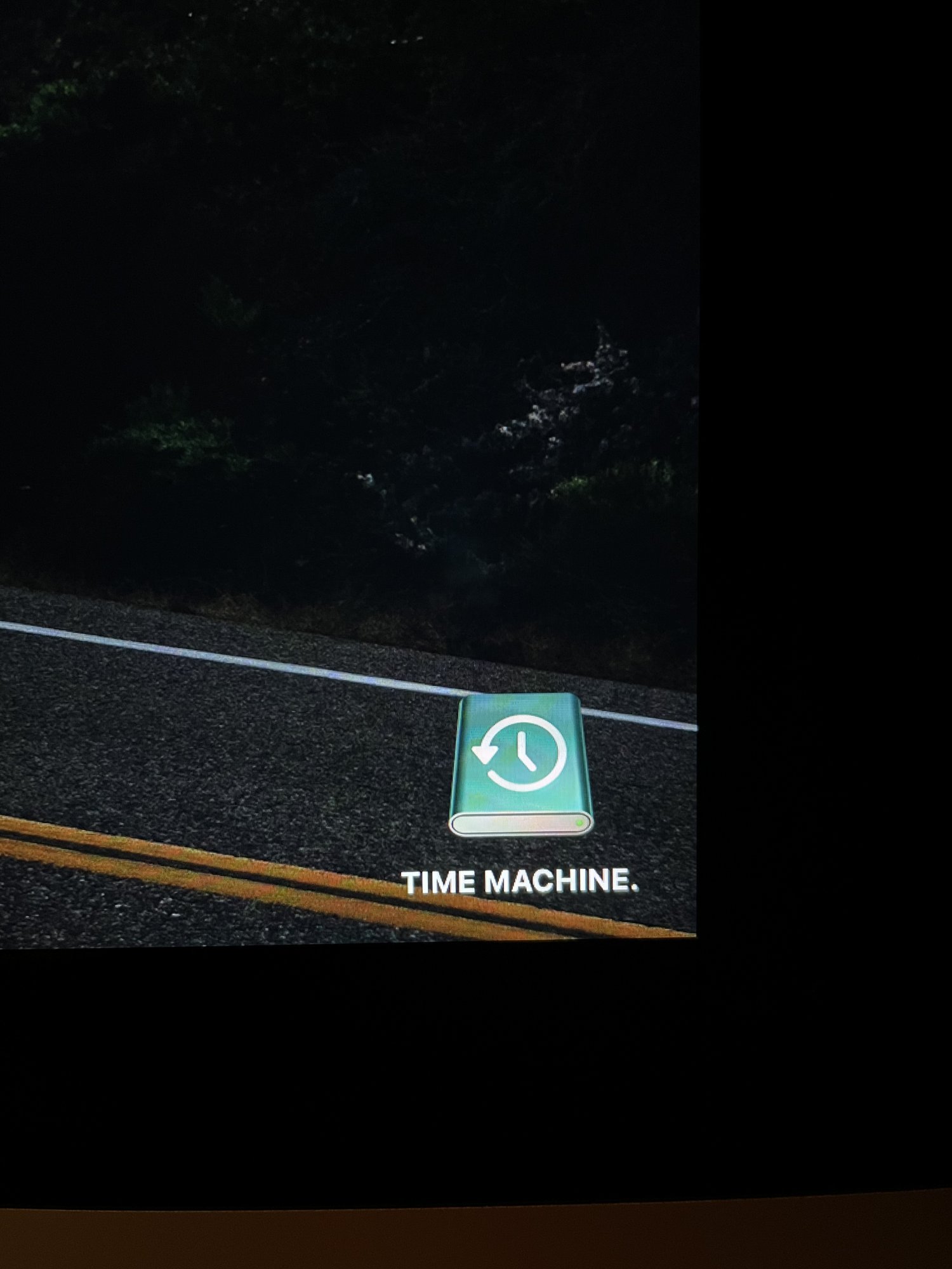

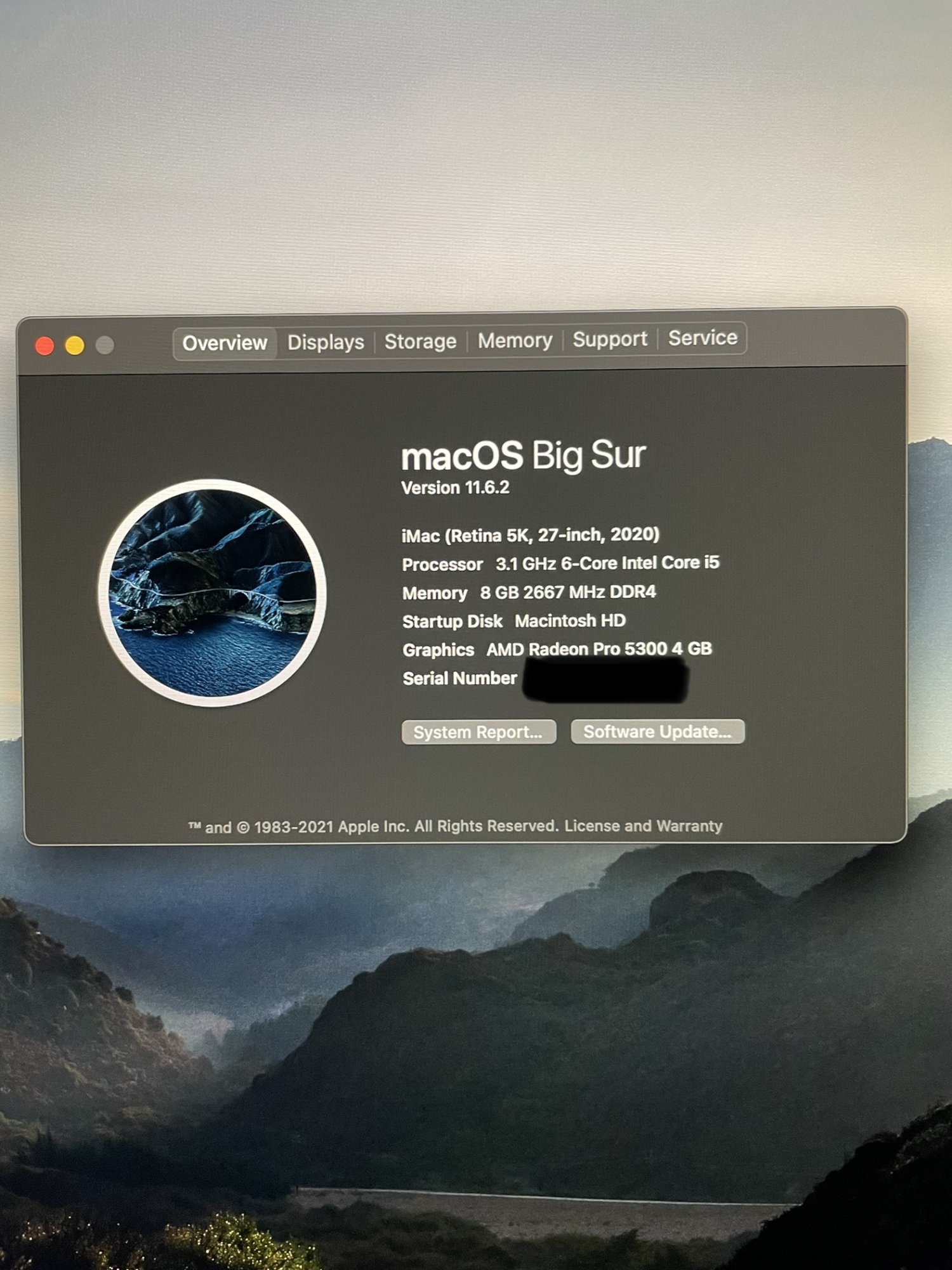

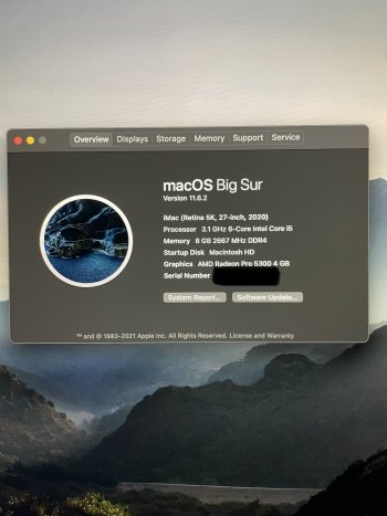

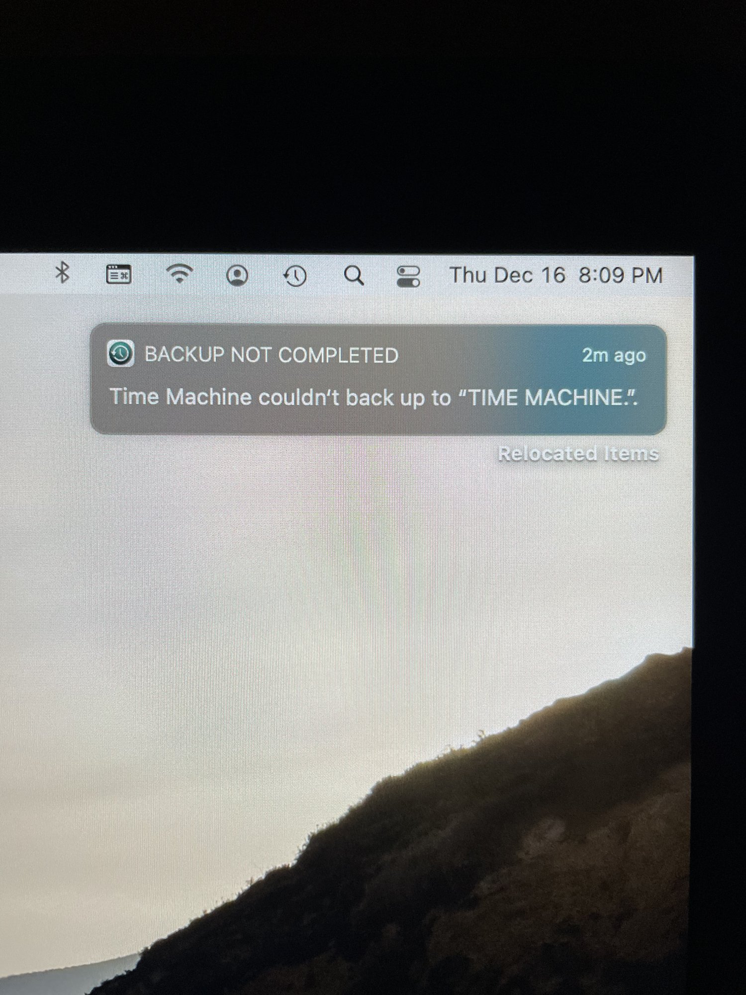

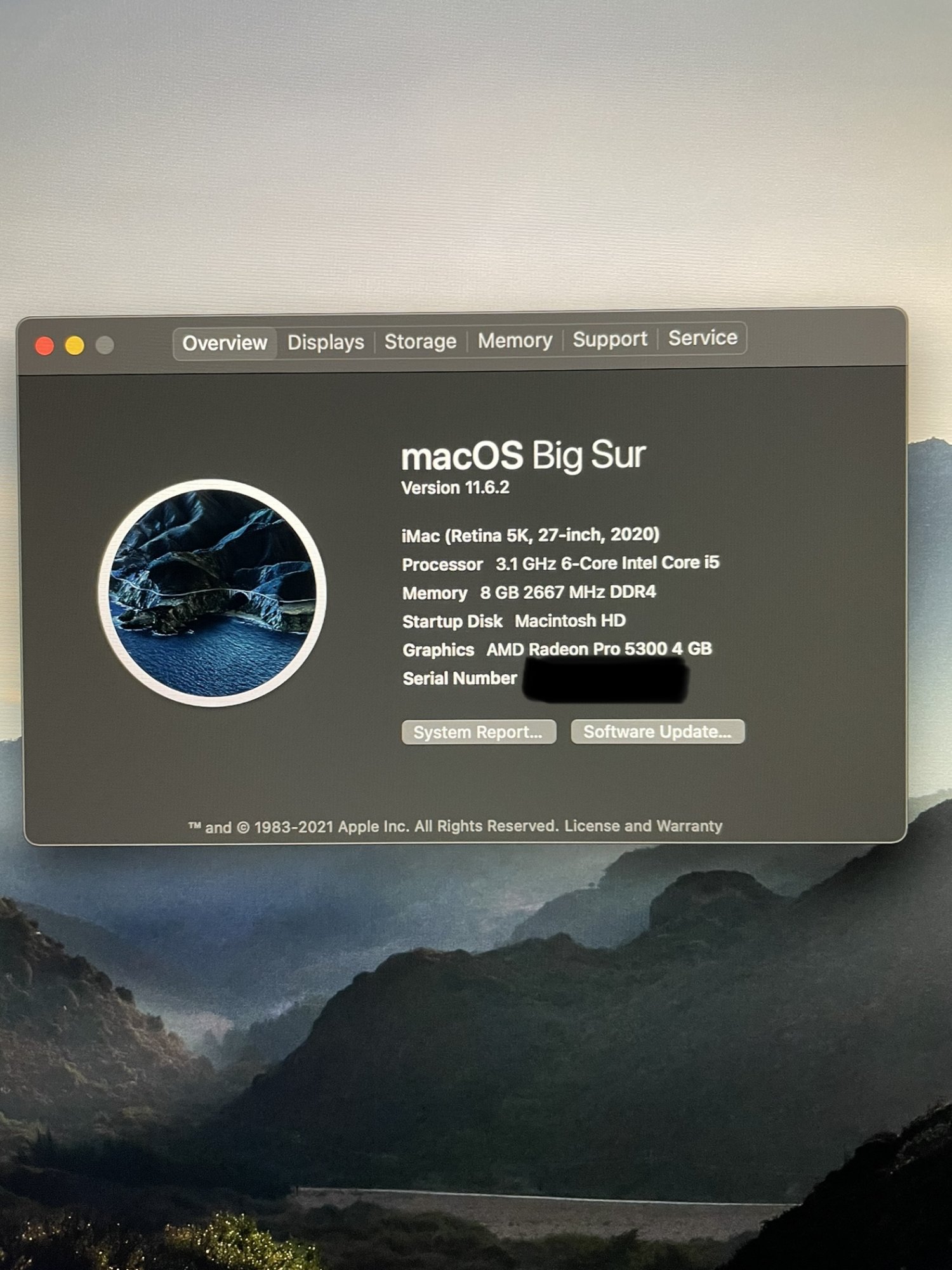

Good morning. I have a 2020 iMac. I hadn’t gone on it for a day and when I did last night it said it couldn’t do the time machine back up and that there was an error. I have a WD external hard drive that I formatted for the iMac. I updated Big Sur and Safari last night as it showed me I needed to. Could that be the reason the external hard drive is no longer doing the time machine backup? Here are some pics of what I’m getting when I try and do the time machine back up. Any help would be awesome. I’m not sure tech savvy, but would like to get this working again. Thank you!
So you can see I have the ex drive labeled “time machine” and you can see the pop up I get when I try to do a back up. You can also see my updates are up to date.

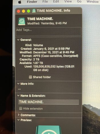

What format is your WD external drive using? (It must be formatted to APFS in order for it to do the backups from Big Sur.)

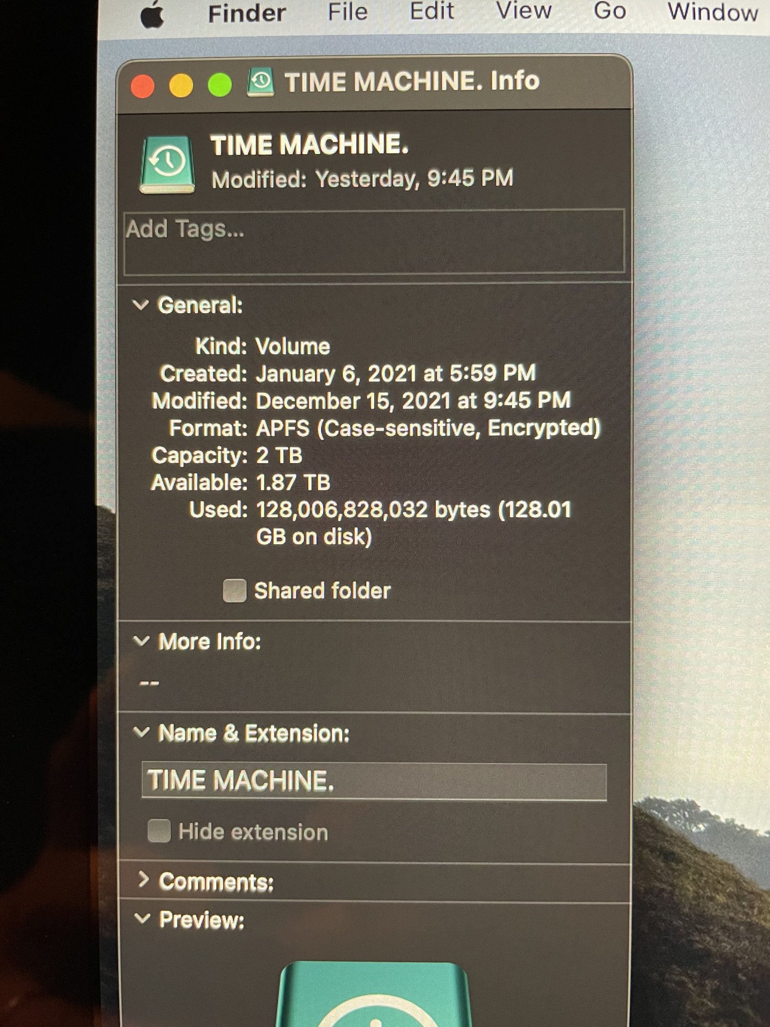

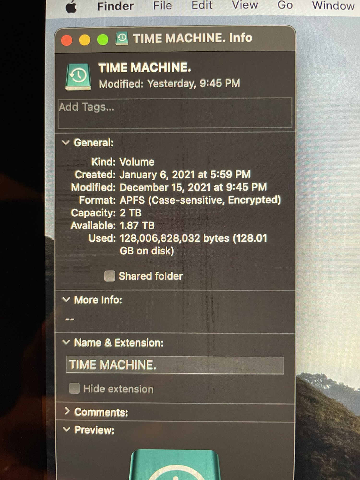

Hello, thanks for the reply. Hmm, not sure how to find out the format it’s using, but up until yesterday it’s been working fine every day since I bought the iMac new in 2020. I’ve done other Big Sur updates and never had an issue, if this is in fact tied to the update. Could you tell me how to check what it’s formatted too? Thanks.

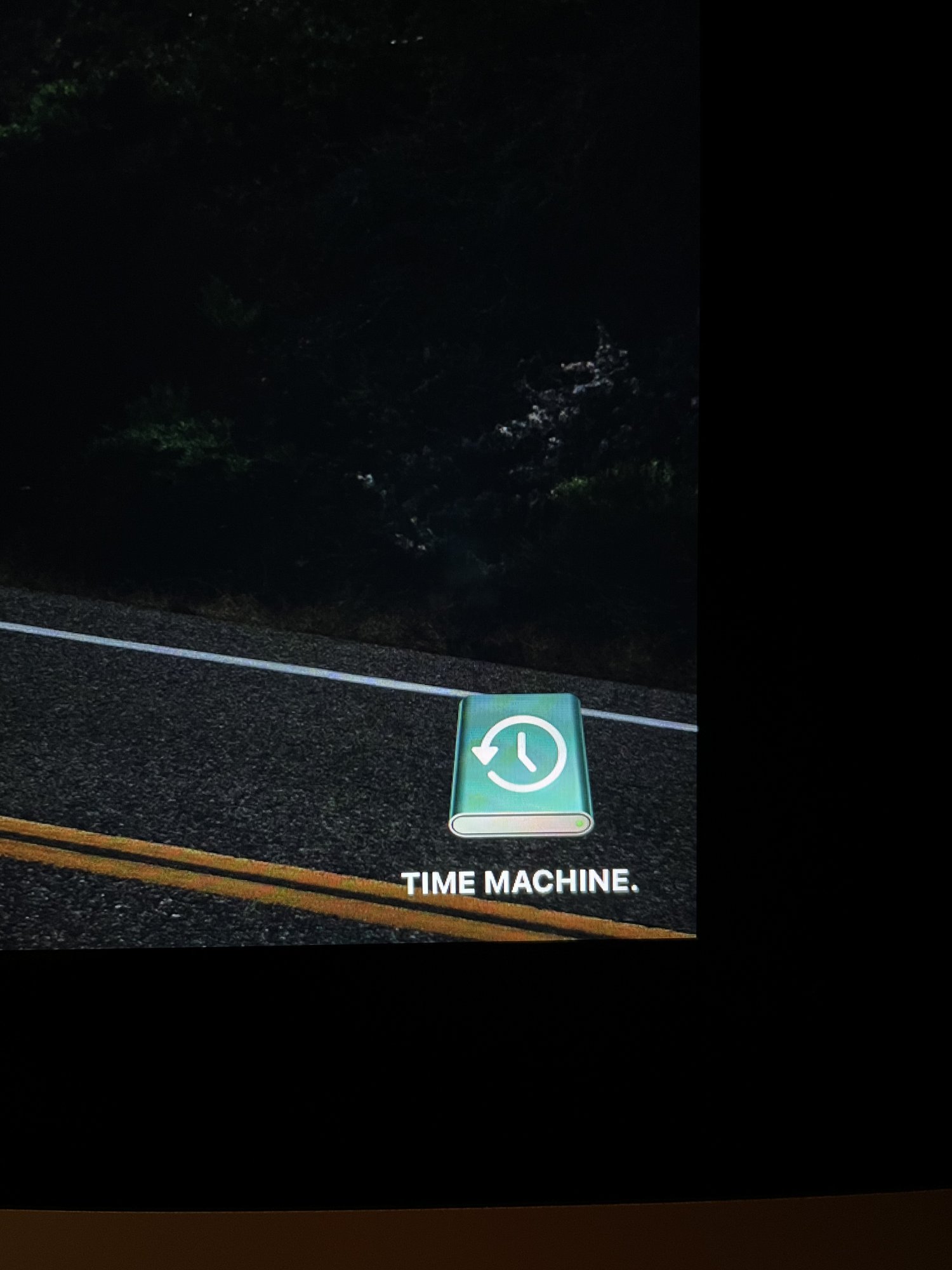

I found it….

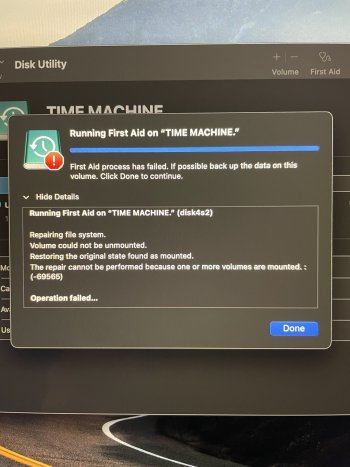

Okay, the drive is formatted correctly for Big Sur. Do a First Aid check on the drive using Disk Utility to see if it comes up with any errors. If it doesn't, it may just have been a one time glitch.

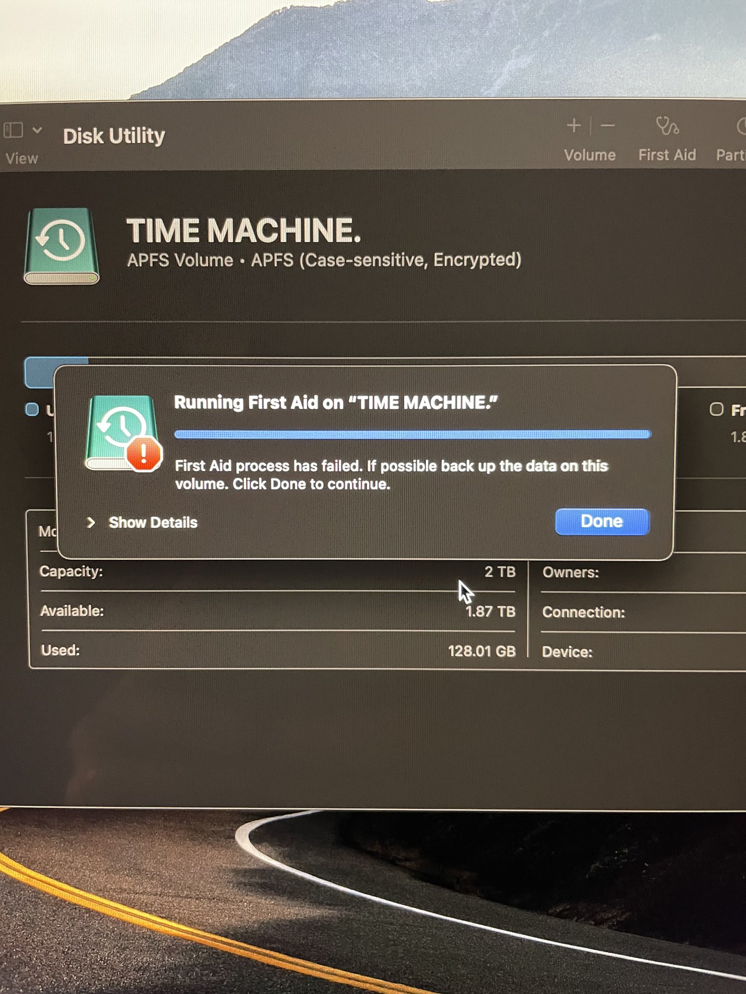

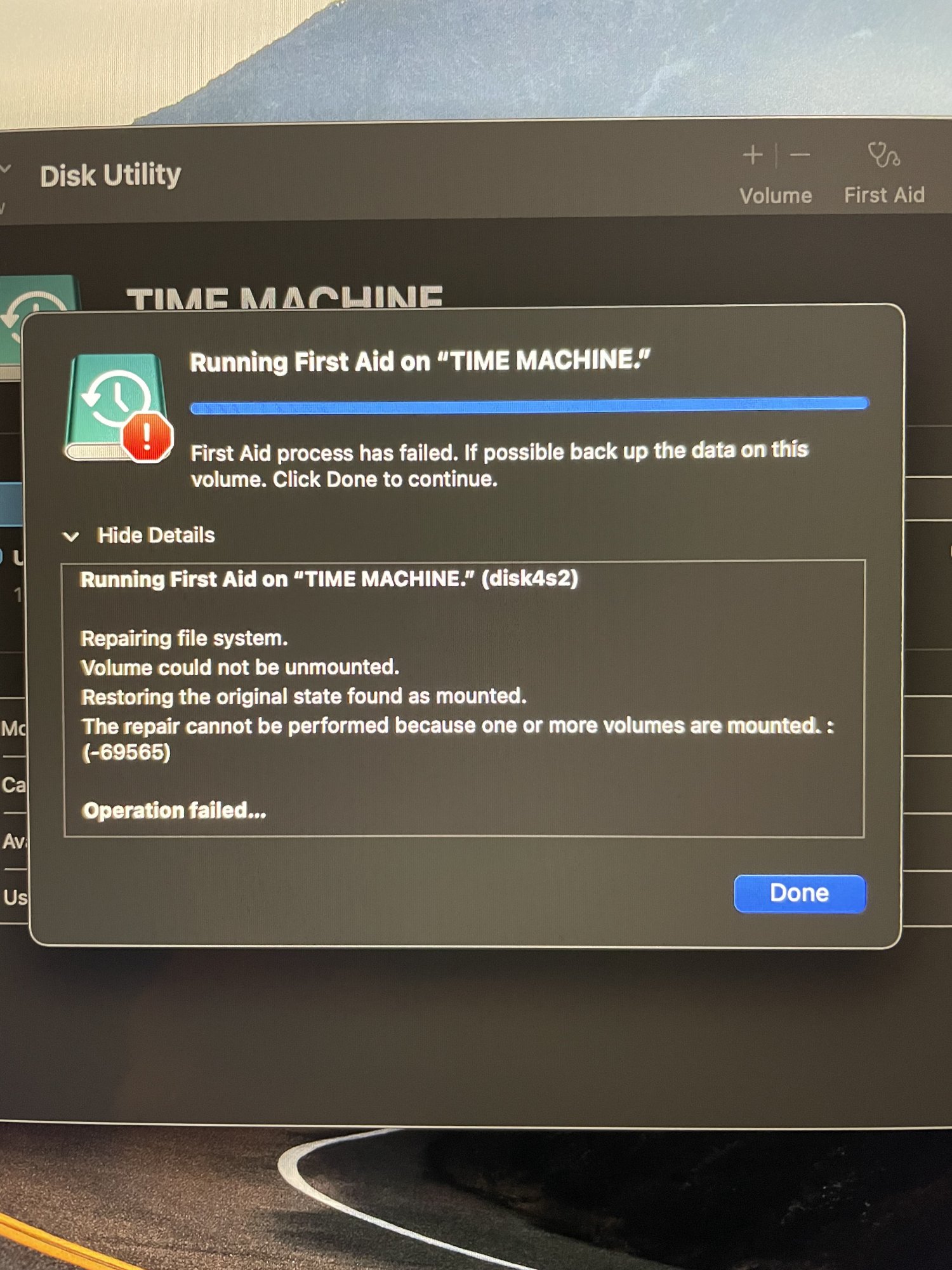

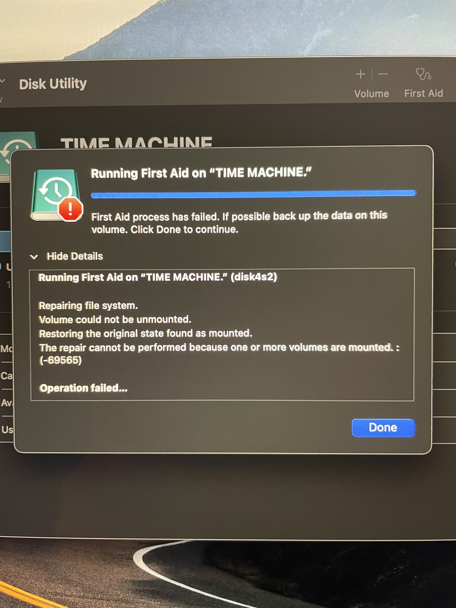

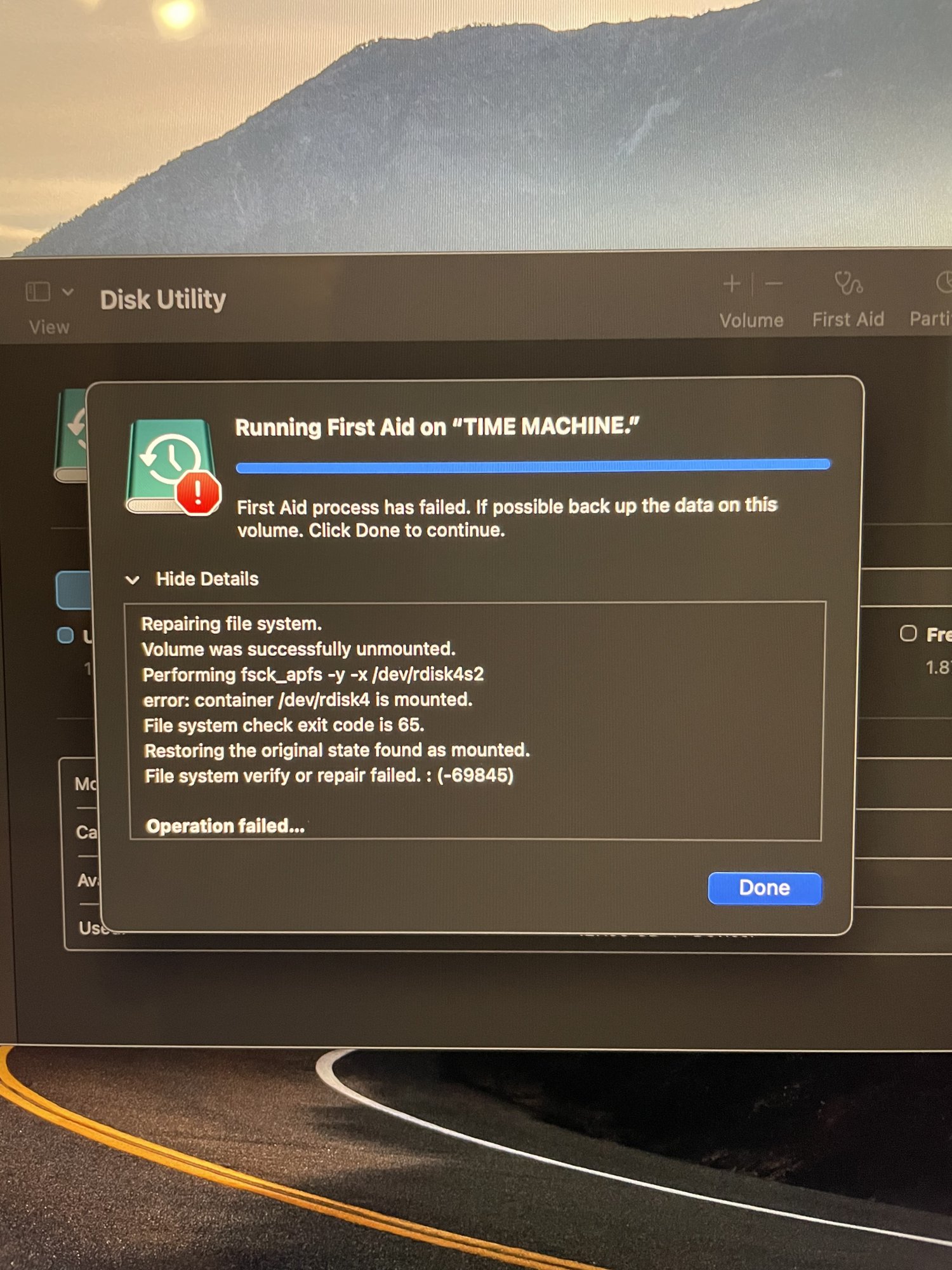

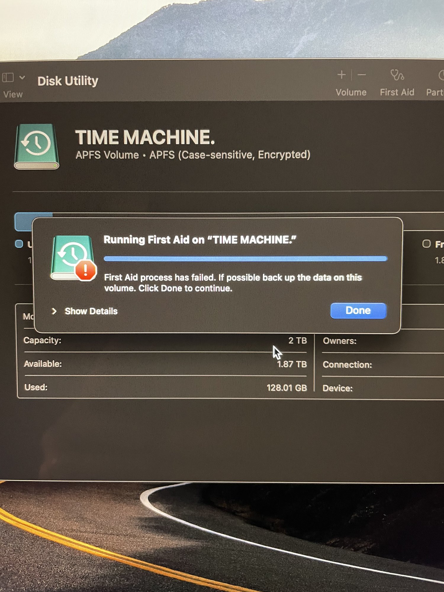

So I did the first aid check and this is what I got…and you can see what it says when I click show details.
More than likely, you will need to erase your external drive and start over. TM has a history (for many here) of producing corrupt backups and or other backup related problems. You should consider moving to Carbon Copy Cloner or Arq Backup for a much more seamless experience, not to mention much faster and offering the ability to backup when you want.

Use Disk Utility to erase the drive. After erasing the drive, do another First Aid check on it. If it shows errors like before, get rid of it and use a new drive instead for your Time Machine backups.

Before doing anything drastic with the external drive I would eject it, let it sit for 20 seconds then plug back in. You can get this error now and then and like a computer, restarting solves the issue most of the time.

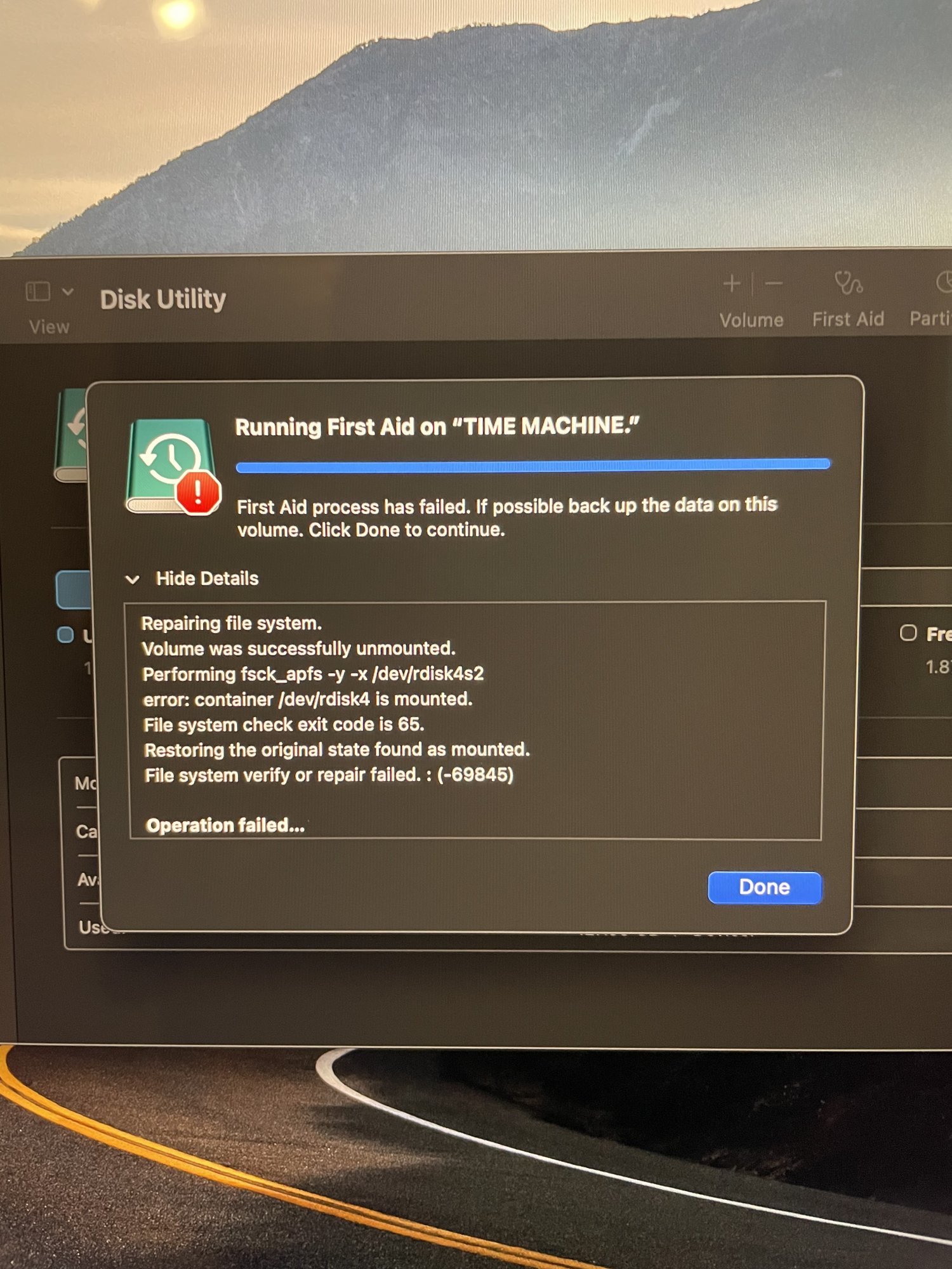

So, I ejected and waited a while and re connected the ex drive. I did the first aid test and this is what came up. Should I just erase the ex drive? Is it possible it’s broken in some way? If I erase it and get a new ex drive for time machine back up, do you think it’s safe to use this one for photos or anything? Or should I not risk it because of this issue? Thanks.
I would not trust that drive for anything. If the drive is still under warranty you can always contact WD and ask for a RMA. It's best to get a new drive (SSD if possible) and use it for your Time Machine backups.
