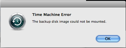

When it first start sup in the a.m. I get the can't repair message. And then every hour on the hour I receive the backup disc can't be mounted error. I have tried to create a new back up; used disk repair utility on both the back volume when I can get it to show up and on the harddrive itself; I have unplugged the external harddrive; etc., etc., etc.

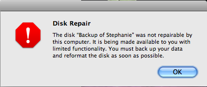

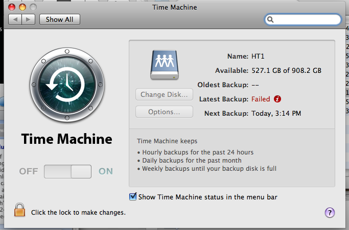

Here are the various errors I have received:
Looks like the drive you're using for TM has some problems. Have you tried reformatting it like it suggests on one of your error messages?

Well, I'm back. Tried deleting the current TM back up, but to no avail. I tried creating a new backup and the computer tells me that the volume can't be mounted. The next step (I presume) is to re-install TM, but when I tried to do a custom install off the Leopard install discs it says that I can't go any further because my system is more up-to-date than the install disc. Is there a way to reinstall "just" TM? Will the 10.5.5 update fix my issue?
Some people are experiencing fixed TM issues using the 10.5.5 Combo update. YMMV.
Still no luck - the machine refuses to mount the backup volume. I have tried adding it to the startup items in the accounts part of system preferences. I can get the volume to show up on the desktop, but can't get TM to back up to the sparsbundle.
