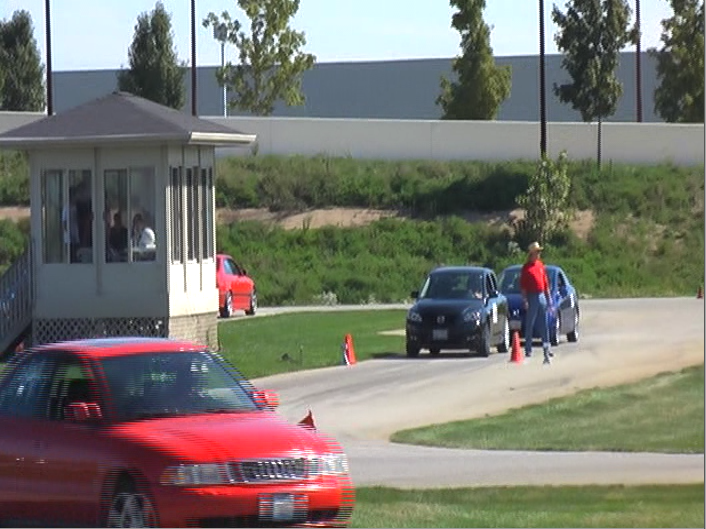

Aspect absolutely needs to be changed; there is no doubt it is narrower than it should be. I'm not exactly sure how 704:480 is the same as 4:3. The video is definitely supposed to be 16:9. I have corrected it with I believe handbrake in past, but there is also a certain loss of quality. Something is getting tweaked (or not tweaked) so the picture is off, as you can see below, complete with interlacing effect.
Still researching...
EDIT: I see... anamorphic PAR. Interesting. More research needed.
EDIT2: I forgot to mention - iMovie imports the videos in the correct, unsquished aspect ratio, albeit with a rough deinterlace job.
[doublepost=1455847729][/doublepost]Ok, I hope I got this cracked. Here is an otherwise unedited version of a random vid from 2008 recorded with the Panasonic, as per the ffmpeg details above, and if I read it right, PAR width 10, PAR height 11...
This is the same vid with PAR width set to 32 and PAR height set to 27 (I think) - and an interlace filter, maybe a bit too much though.
