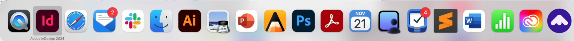

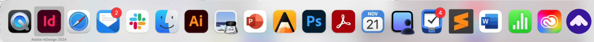

Honestly any Apple Silicon Mac is going to feel like a massive upgrade. Here at work, I'm running an M1 Mini (M1, not Pro or Max) with 16 GB of RAM and it crushes my workload easily.
Here's my dock at this moment. Note Illustrator, Photoshop, InDesign, Word, PowerPoint... it's all running very smoothly even as I multitask quite aggressively trying to get some files edited quickly (which I should actually be doing instead of posting here LOL).
Reactions: drrich2
