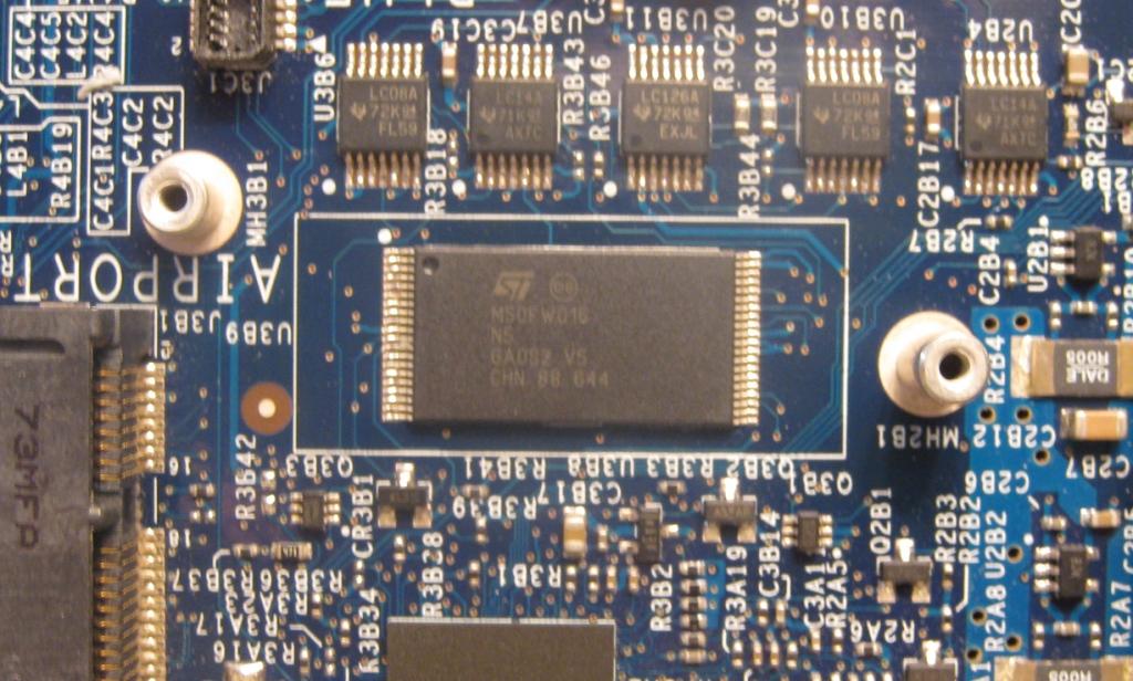

The Flash part for the mp1,1, mp2,1 (06/07) models is the STMicro M50FW016. I'm reasonable confident that the mp3,1 (08) uses the same part but I don't know for sure.
I've no idea what's in the mp4,1 (09) as I've not seen the insides of one. However I do know that it will be a 4MByte part. Can anybody locate and take a pic?
yucky poo
i will get a look at mine soon...but i just put the airport card in
and while I have added Sil TMDS chips to cards in past, it was touch and go.
thats gonna be a toughie
best if we don't need to switch it
