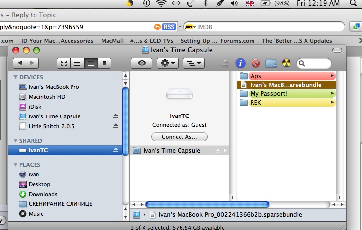

Yes, everything is fine and light is green,i am connected wirelessly to TC and can menage some files which i did by drag and drop(i am realy ashamed now😱) i can access setup in Air port but TimeMachine wont backup says
Time Mashine error : The backup disk image could not be mountrd

OK you're connected to the TC, you've got internet access, it seems mostly fine.
Just need to sort out the backup.
Have you completed the first backup? The first one takes a very long time. Overnight or longer. It takes even longer if you do it through wifi. If you stop in the middle, (e.g. close the MBP, or it goes to sleep) it won't complete backing up successfully.
Does the Time Machine application open succesfully and find some old files?
If you havn't completed the first backup, delete the backup file, and try again.
Turn off your MBP wifi, connect it via ethernet, turn off sleep ('always stay awake' ), start the backup, and leave it overnight.
