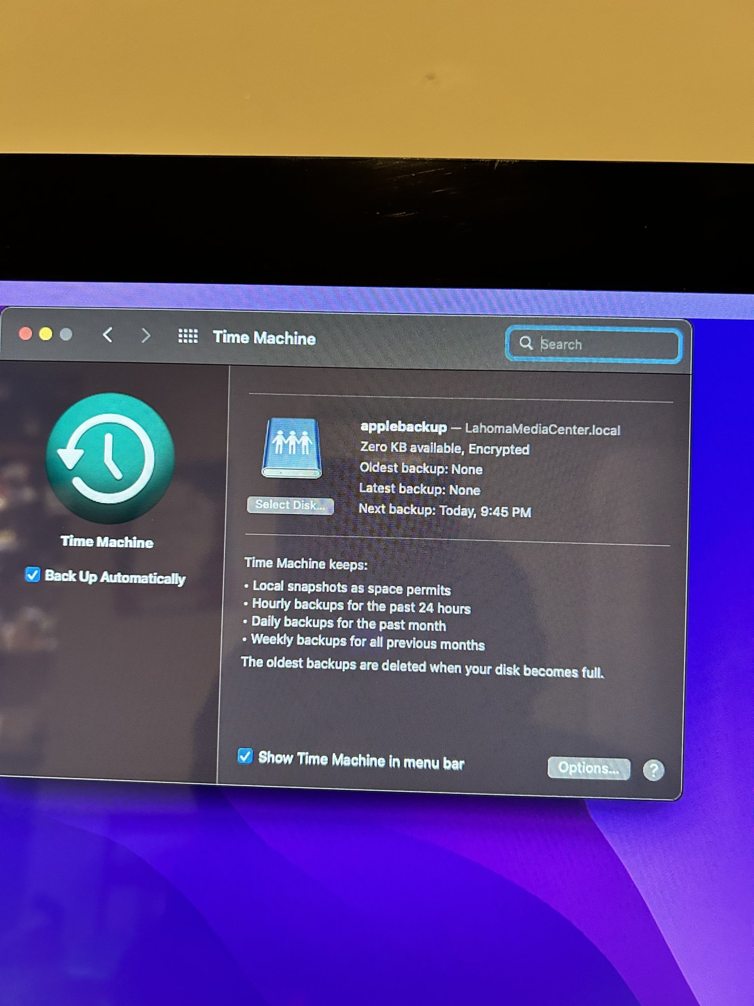

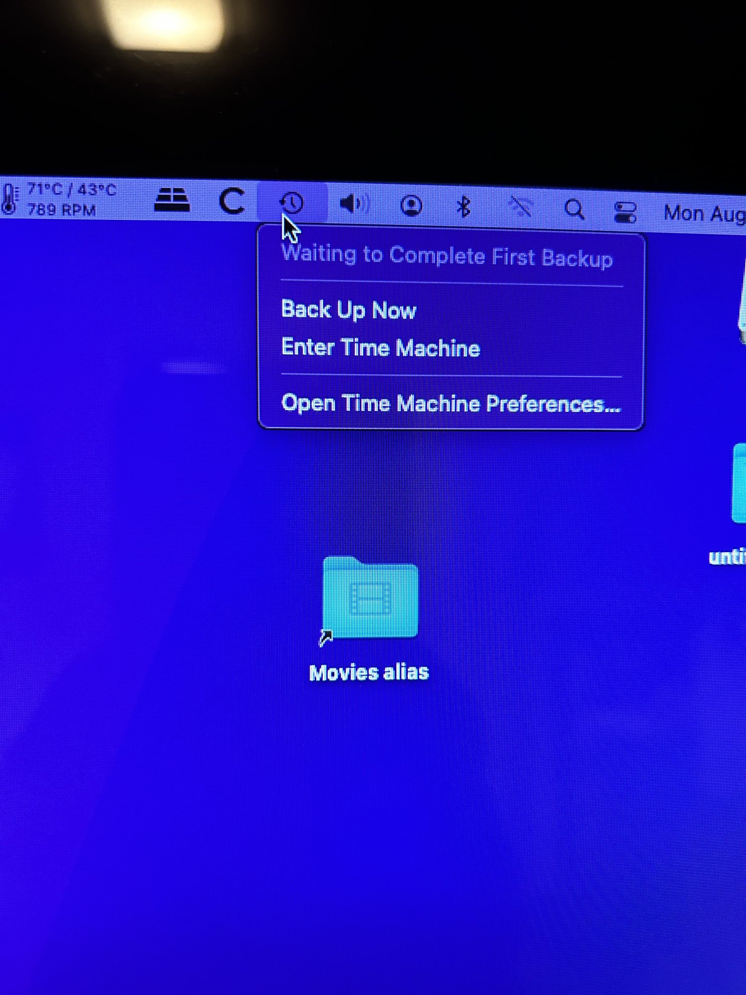

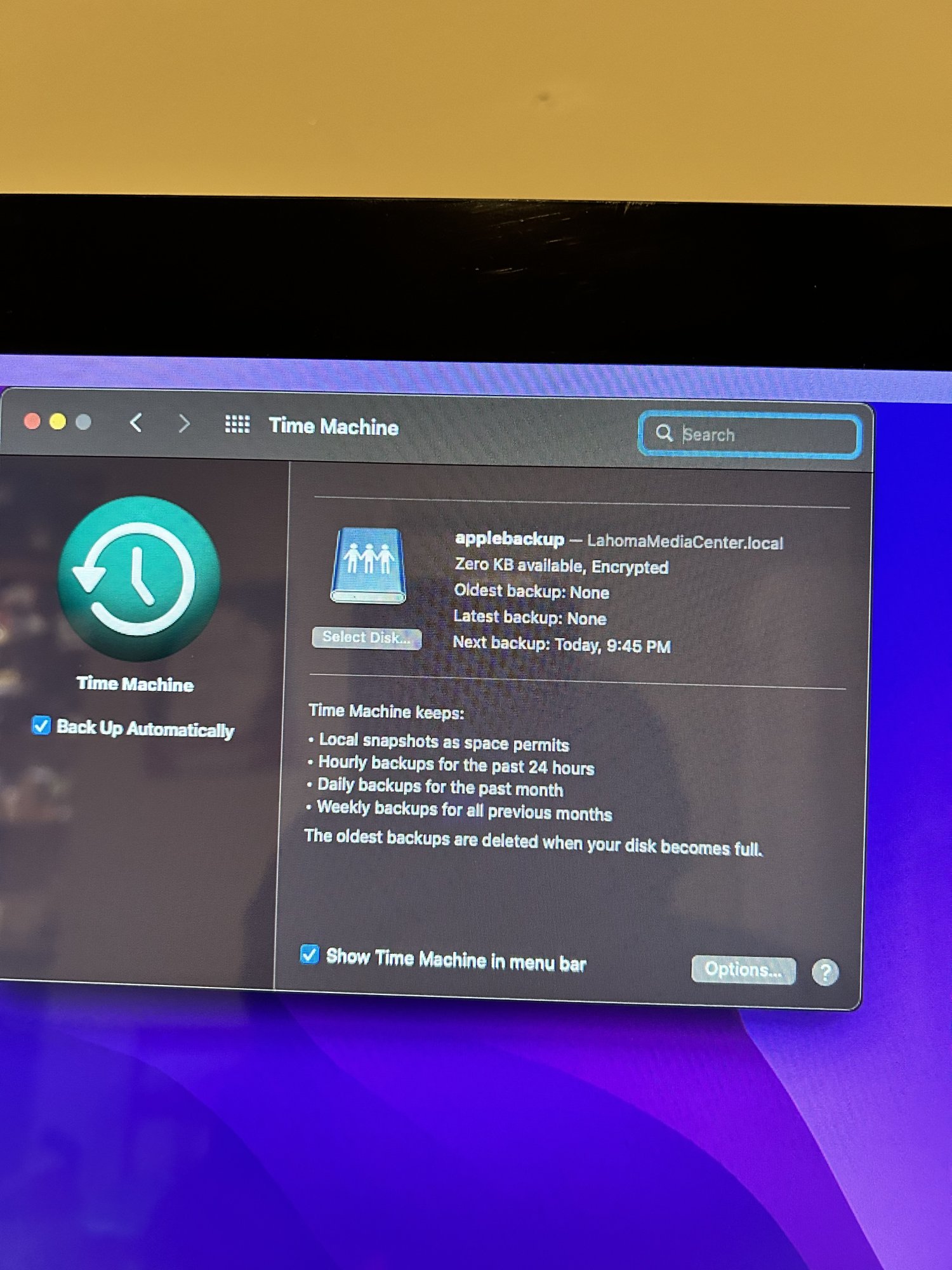

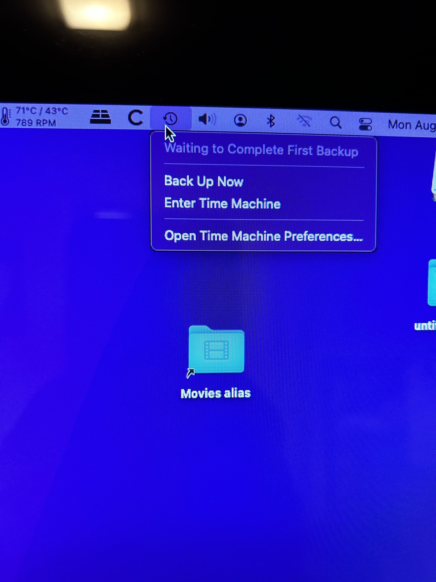

TM will start the backup run for maybe 20 minutes and then display Waiting on First Backup to complete. when I open the TM preferences
it tells me zero kb but its not .

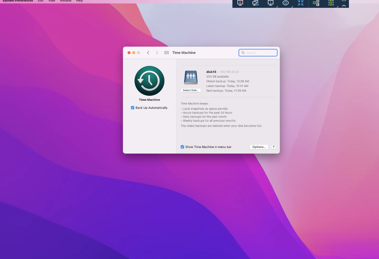

I also have a cMP5,1 running open core on the latest monterey and TM is running flawlessly. The share it uses is on the same nas and setup the same way.

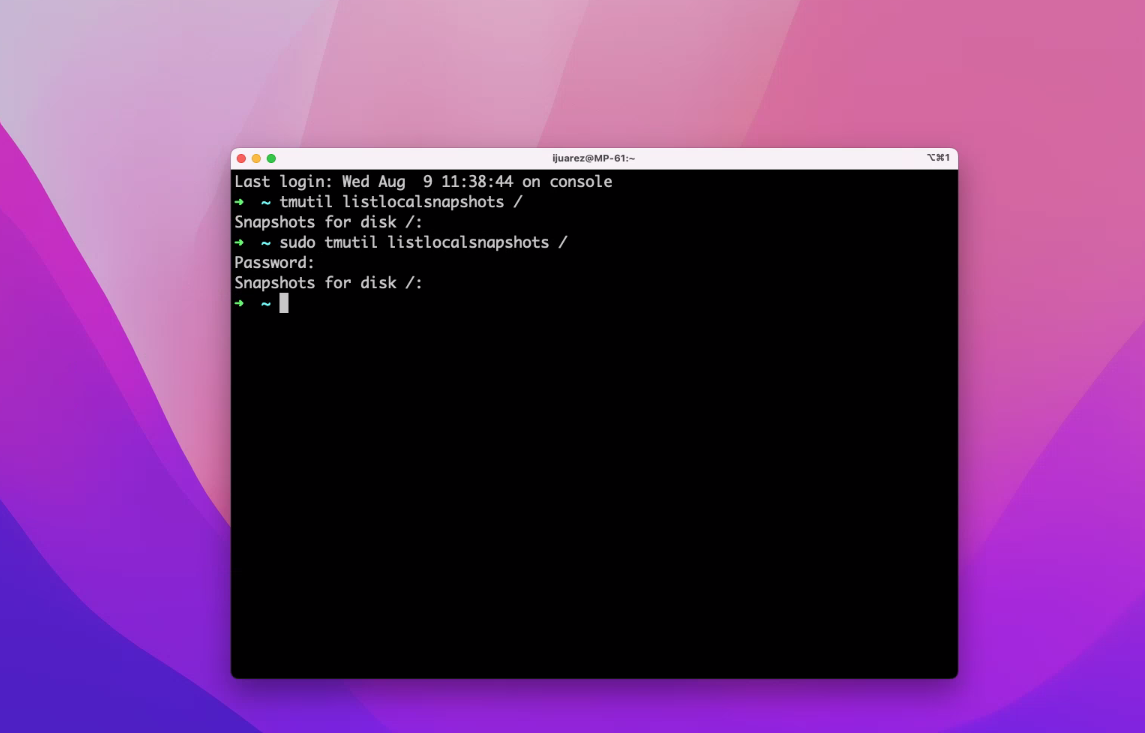

Then, if they're functional, I'd be inclined to start a fresh TM backup (perhaps after using TMUTIL to remove any local TM snapshots on the internal drive), and try a backup with those user accounts home directories added to TM's exclusions list - if the backup works, then add in one of the accounts, and try again, etc.
