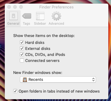

This?
How do I find the boot volume? I never saw it when I tried to back up today, it would go so far than just stop. That is why I am thinking I should just wait to back up once I'm out of the the BETA mode.... Is there a website I could print directions out somewhere?
go to Finder/Preferences, look for 'hard drives' make sure that there's a checkmark, and then there should be a drive icon on your desktop.
