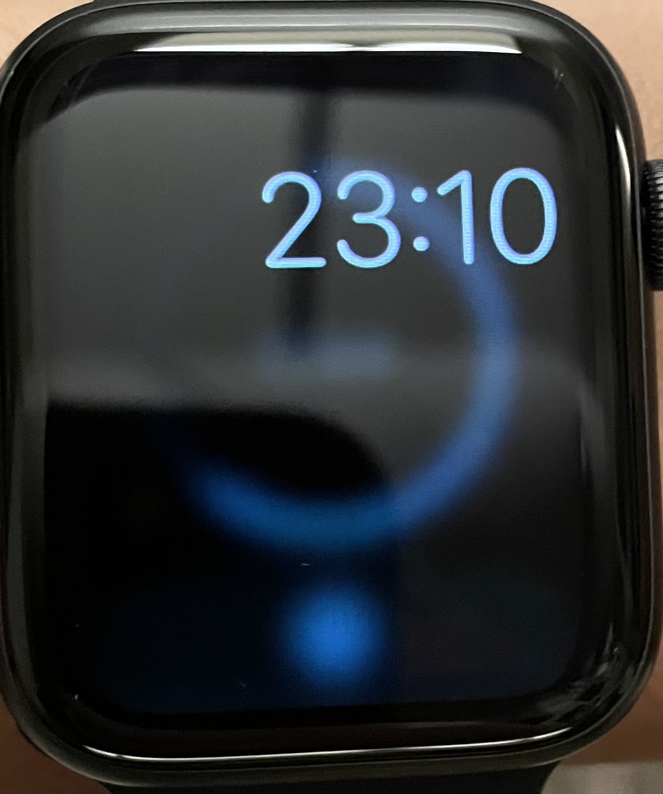

I tested Infograph. I also tested Infograph Modular and I can confirm that the ring works better on that when the screen is on full brightness.
When the timer is running on foreground full screen (Tiny Timer itself is full screen and on foreground) and the screen dims, the app blurs and the digital clock appears which is the feature of always on screens when an app is running. It is not possibe to take a screenshot but I am attaching a photo of the screen. The screen (blurred ring) also does not update while it is in this situation. It only updates when I raise my wrist.
I suggest you should focus on the complications instead of the UI when in full foreground and dimmed. Because the blur effect will hide most things you do while dimmed.
I also took a look at what Apple does with its timer when in full screen. I think it uses a special mode that the workout apps can use which blocks the blur effect so the app can show its interface while dimmed. But when dimmed, it greys out the ring and seconds, and only shows the minutes. And it updates only every minute. But you can immediately tap stop or pause buttons while the screen is dimmed.

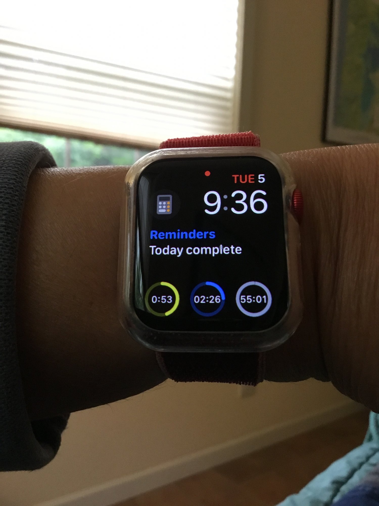

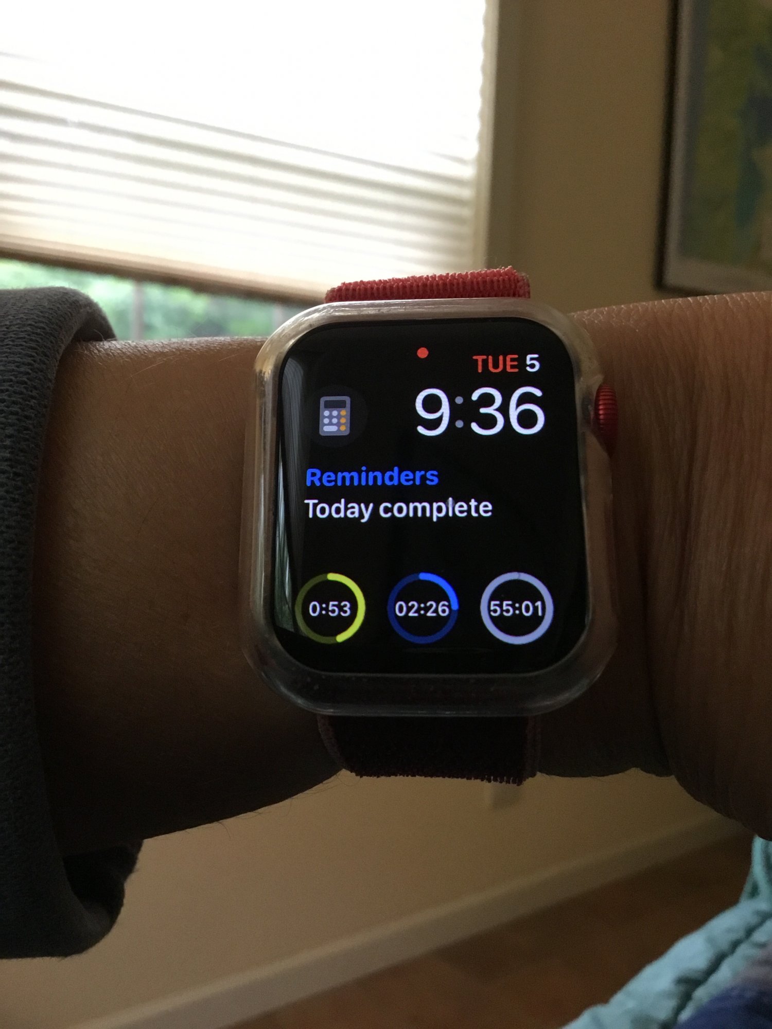

I have a dedicated Series 6 watch face just for tiny timer. Always on is enabled and I’m running whatever version of Tiny that was available in July when I upgraded my watch. Works a treat for me but I do hit the dial button to bring it back to the complication screen after setting the alarm. If I don’t, I might miss the alarm. I find that true of the Apple timer, too.
Looks great. 😎 When a timer expires and Tiny Timer is currently running in the foreground, you should get an alert and a notification sound in the app. I'm currently investigating a watchOS 8 issue where the notification is not delivered when you close the app a few seconds before the timer runs out.

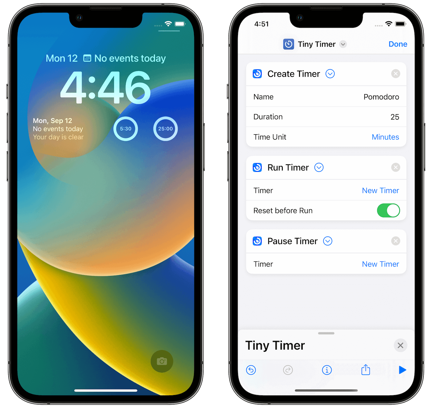

Hi,
I’ve released a new Tiny Timer update for iOS 16 today. 😊
  • Lock Screen Widgets: You can now pin timers to your lock screen for quick access.
  • App Shortcuts: Tiny Timer integrates with the Shortcuts app. You can create, start and pause timers. These actions can be automated and integrate with other apps.
The update is now available for download on the App Store. The new features require iOS 16 and are therefore currently only available on the iPhone. iPadOS 16 is expected to be released in October. Tiny Timer will also continue to work on all devices with iOS 15.
As always, I'm happy to answer questions and provide feedback. Just post a message in this thread.
