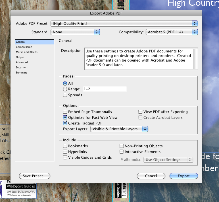

How are you creating your PDF? Are you making a PostScript file and converting it to PDF in Distiller? Are you saving to PDF from the Print dialogue box? Are you Exporting to PDF from InDesign? Damn! This is complicated...😱...
Post a screenshot of the PDF set-up box you get when you make your PDF. Something like this.

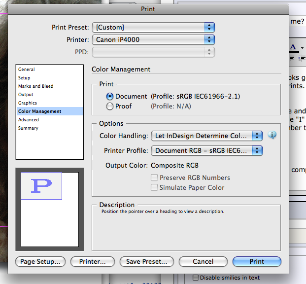

I've followed some of the instructions I've read here and still can't print the way I want.
When I print in InDesign, it looks good on the screen but looks really washed out when it actually prints. (It prints great in iPhoto and everything else though.)
I'm attaching the window I see and can't change the Color Handling to my printer. You'll see there's a little "I" to the right of that and when I put the cursor over it it reads: Remember to disable color management in the printer driver dialogue box.
Where the hell is that?
And be gentle. I'm not all that computer literate. Thanks for your help.
Randy in Toronto

Well you see that button second in from the left on the bottom of the dialog?
Clicking on that will bring up the Printer Driver controls. If available in there, you need to find a control which turns on or off the PRINTER colour management, thereby handing control over to InDesign. Also while in there you get to choose the printer paper type - depending on the printer this usually has a significant effect on print density/quality. Once done, click OK and return to the InDesign print dialog, then print.
The trouble is with printing in Adobe apps on the Mac, it's a three way battle between Apple's print options, Adobe's print options, and the print options offered by the Printer's driver. Unless you get all three working in harmony, it can be confusing.
Oh, I also notice you have 'sRGB' as your printer profile - this is clearly incorrect. You need a profile which is provided by your printer manufacturer, so look for something Canon-related. It may also be specific to the paper used.

I did some of what you asked and couldn't figure out the rest. The up side is that whatever I did worked.
The downside is that it all really looks saturated now.
What's the trick to printing so that it looks more like what you see on the screen? I know it's a bit of an apples and oranges thing but it not really very close.
Thanks again for your help on this. You got me to a point where at least I've put my gun down.
