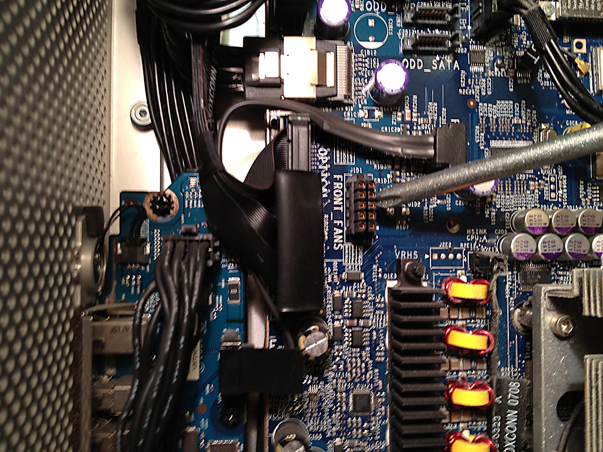

Here's a pic of the front fan connector. It's on the board and connects to the fan housing.

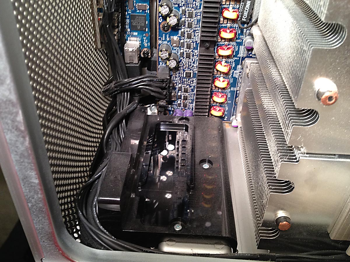

Fan foot mount. It DOES pull straight out, but requires some wiggling.

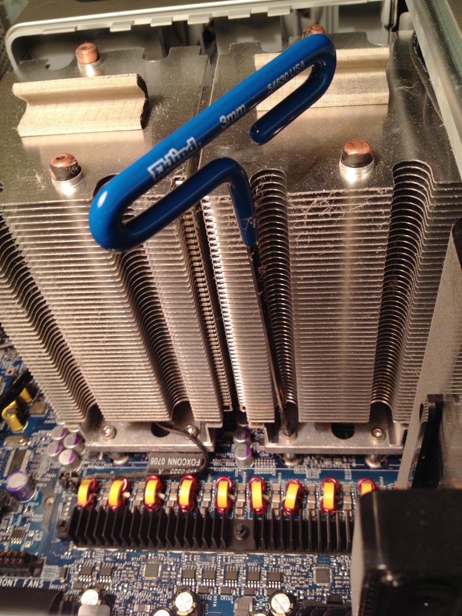

Here is my 6 inch allen wrench. Notice how close it is to the top of the heat sink. At the bottom edge of the case (on the very edge of the photo) there is not enough room to turn the wrench. So you really need either a 7inch wrench, or a ball wrench for the tight spots. Plus, when you put things back together, it helps to be able to tighten 2 screws diagonally at once for even pressure.

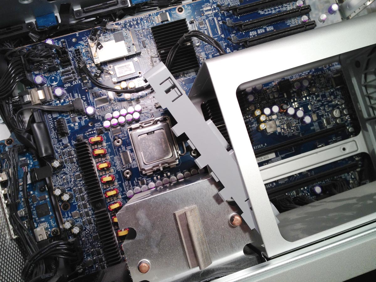

Here is taking out the RAM cage plastic guide. I used a thin plastic card (like my health insurance card, thinner than a credit card) to pop the plastic tabs. It was easier to take it out at an angle after 1 heat sink was removed.

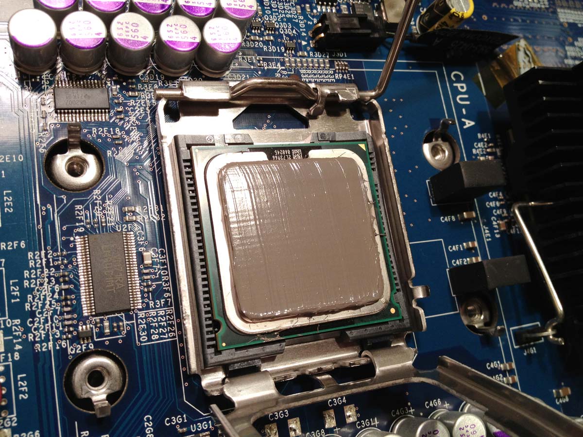

Use a plastic card to smooth out the thermal paste. I used the Radio Shack Arctic Silver. A guy at another computer shop said to spread it with your finger, but that's BS. Why get oils from your hand into it? Use a plastic card to smooth it out. I used about 1/4 tube on each processor, but I'm told you don't want too much. Maybe I used too much. Just make it even and smooth.

It's not necessary to spread thermal paste all over the CPU cover like that.
There is a specific way to do it for Intel chips, usually you're supposed to just run a thin line across the CPU cores and let the HSF spread out the paste when you mount it:
scaled.php
Not saying you'll have problems doing it the way you did (I did it that way myself for many years before learning the correct way), but it's not the optimal way to apply thermal paste, which could amount to a few degrees CPU temperature difference. It also looks like you applied a little too much thermal paste in your pics. You really only need a very very thin layer.
Edit: Here are some instructions for your X5365 (Horizontal Line method)
Those who have one of the 5100 series Xeons need to use the Vertical Line method
