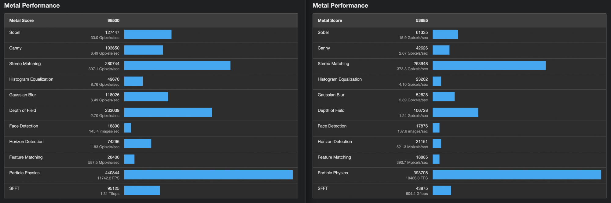

Radeon VII Geekbench Metal (1st with Radeon Boost, 2nd without)
Radeon VII Geekbench OpenCL (1st with Radeon Boost, 2nd without)

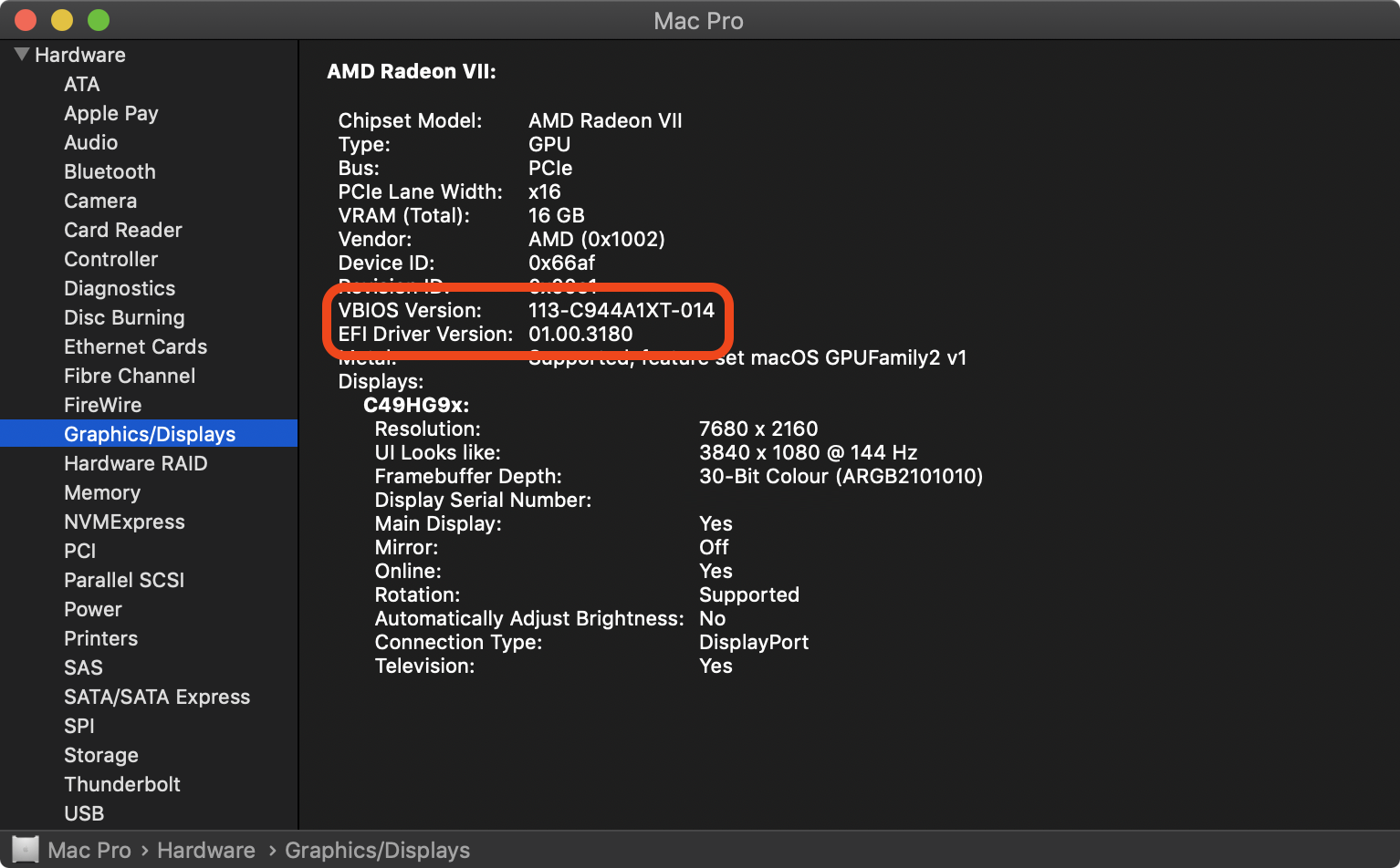

Also, it's feeling more "complete" to see the VBIOS version and EFI Driver version for my Radeon VII now 🙂

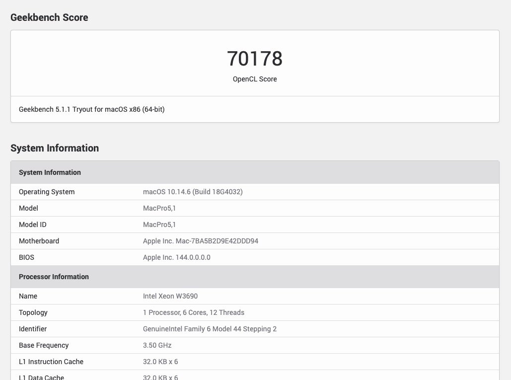

I can confirm that CMMChris's RadeonBoost kext works as expected on cMP.
Also, as a beta tester of this kext, I can also confirm that no stability issue after running this kext.

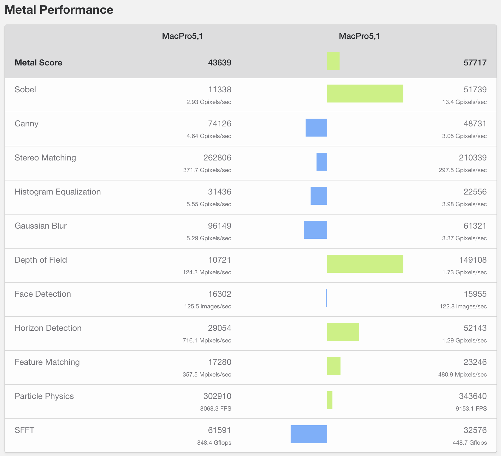

As an owner of a Radeon VII, the natural question then is: will it improve performance on anything besides GeekBench? 🤔
I suppose it overrides whatever PowerPlay table you have already implemented?
Slow score is with the RadeonBoost kext (blue) and the normal score (green) is with my own overclock on VEGA FE.

The only difference RadeonBoost.kext seems to make is that the GPU fan hits 100% for about 5-10 seconds during mid-boot (remains slow/silent without the kext), which suggests that the kext is doing something. Various benchmarks were identical with/without the kext, and there is no noticeable difference in normal usage.
(EDIT: I do see the VBIOS Version and EFI Driver Version in System Information, so the kext is definitely being loaded.)

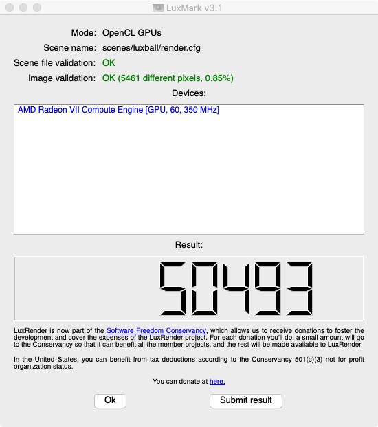

Do you think this is due to lack of explicit support for RX570, or something else? In every other context I've tested, the RX570 is functionally identical to the RX580, just slower.
benchmark works in geekbench as kext in library/extensions
openCL 71940
metal 95118
but luxmark ?
and furmark with 44fps without 59 fps !?!

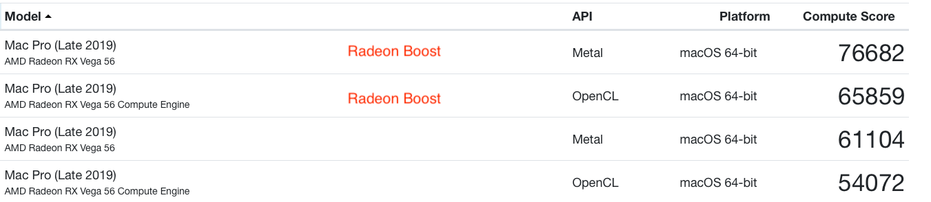

I've install it in my 7,1 MacPro with a Vega 56 and the difference in performance looks very good in GeekBench. The downside is that now, my Vega 56 fan is loud even in idle. Any ideea how to turn it down ?
i've put the kext in /Library/Extensions
then i've run these commands in terminal :
Code:
sudo chmod -R 755 /Library/Extensions/RadeonBoost.kext
sudo chown -R root:wheel /Library/Extensions/RadeonBoost.kext
sudo touch /Library/Extensions
sudo kextcache -update-volume
reboot
This is the detail scores comparison from my Radeon VII.
Apparently Something like Sobel can benefit from this kext a lot. But Stereo Matching perform pretty much the same.
And NO, this kext shouldn't infringe the PowerPlay kext for downvolting. I checked that on my cMP.
