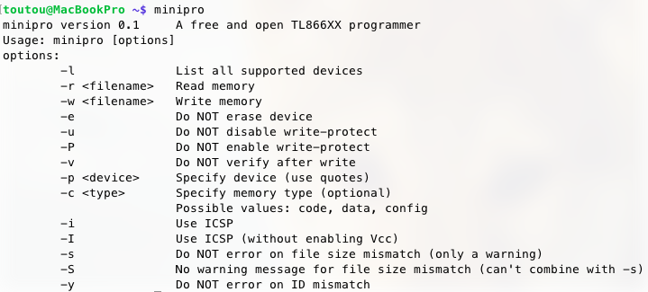

I tried this for you and it seems to do something. (it's a a command line app)
The process is pretty straightforward, just get the app from Github (download directly or via git if you're familiar), then enter the directory in terminal and run
Code:
make
, then
Code:
sudo make install
You'll need the libusb library (available from Homebrew) and the xcode command line tools (a prompt will come up automatically if you don't have them)
Just ask if you have any questions.

4) so now I checked to see if the above GCC stuff was installed and the paths, as explained in the GUI docs, but in my case the results were slightly different:
which minipro
which showed the path here being: /usr/local/bin/minipro
then check the avr-gcc path:
which avr-gcc
which, on my computer said it was here: /usr/local/bin/avr-gcc
and then check the avr-objcopy path:
which avr-objcopy
which I'm told is here: /usr/local/bin/avr-objcopy

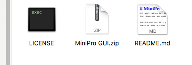

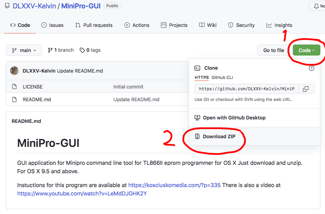

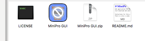

First I'm not sure if I'm getting the download right. On your Minipro-GUI Github page I clicked on the green "Code" button, then on "Download zip", like this:

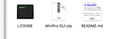

After unzipping it on my Mac I was left with a folder containing two files:
Seeing that "LICENSE" appeared to be a command-line type file I double-clicked it, which appears to be somewhat in the right direction, although I received some error messages in the Terminal:
$ /Volumes/Users/USERNAME/Downloads/MiniPro\ GUI\ for\ Mac/MiniPro-GUI-main/LICENSE ; exit; /Volumes/Users/USERNAME/Downloads/MiniPro GUI for Mac/MiniPro-GUI-main/LICENSE: line 1: MIT: command not found /Volumes/Users/USERNAME/Downloads/MiniPro GUI for Mac/MiniPro-GUI-main/LICENSE: line 3: syntax error near unexpected token `c' /Volumes/Users/USERNAME/Downloads/MiniPro GUI for Mac/MiniPro-GUI-main/LICENSE: line 3: `Copyright (c) 2021 DLXXV-Kelvin' logout Saving session... ...copying shared history... ...saving history...truncating history files... ...completed. [Process completed]
So where did I go wrong? Did I misunderstand something perhaps?

I’ll be honest with you I’ve never used Git before. Let me see if I can figure out the problem. I might need to use a different download site
The file is in there now. I forgot to commit when i uploaded it last night. Good job on me testing the download. Sorry about that
No problem 🙂

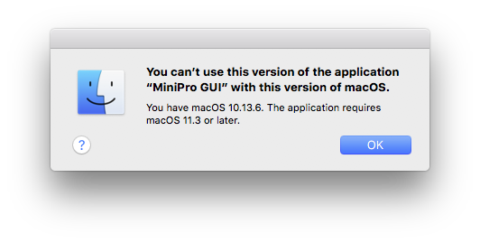

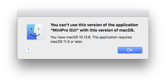

But now I have another problem:
Is there a specific reason you made it not work with anything but the latest OS, or is this just a matter of "allowing" the app to run on earlier OS versions? I'm still on High Sierra 10.13 because of some old software I'm still using (ands I don't think MacOS 11.x can run on my computer anyway), so it would be great if the GUI could be made to work on my older OS.
Also, there's now a ZIP file inside the first ZIP file. Maybe you could just put it all in a single ZIP file?
No problem 🙂

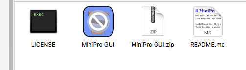

It’s because git automatically puts things into a zip file. As for the app, it should have been for 9.5 and up but must have not set the compile correctly. Let me recompile it

OK, I recompiled. I forgot to set the Target. It's now set to 10.10 (as low as I can go with it) that is Yosemite. Thanks for doing all the testing. I don't have any older Mac atm. Hopefully you aren't too frustrated. You can just re-download it and it should be good to go.
