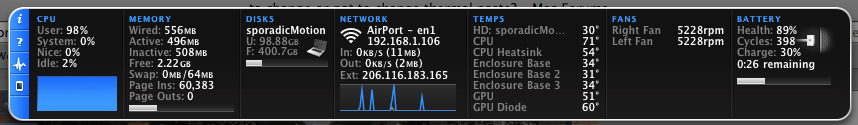

Here is SMCfan control off - idle (I realised I still have Fan Control Installed, will re-post when that is done)
Will post the rest load results soon 🙂

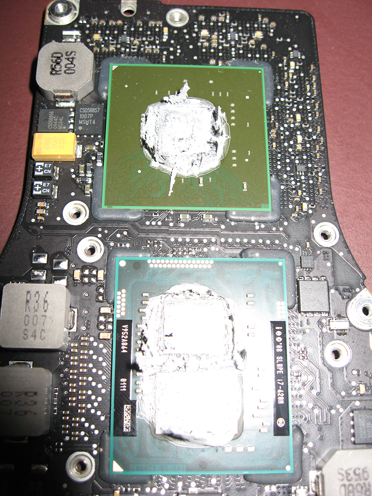

This is what my motherboard looked like when I got it:

Once I got the heatspreader off, I found the thermal paste looking like this:
Not necessarily too much, nor too little. But still on the + side. Moreover I suppose that the constant low and high temperature shifts on a laptop causes the Thermal Paste to "age" faster than it would in say a desktop.
Are you serious? That's way too much. It shouldn't be pouring out the sides like that and smothering the rest of the chip. Also, it depends on how often the desktop is shutdown or slept too. 😉
I use even less than that. The entire purpose of the paste is to fill in gaps in the surfaces so heat is conducted faster and easier across the bridge, so there shouldn't be more than very thing coating to start with.
For the thermal paste, I applied as thin of a layer as I deemed reasonable. I made sure to avoid too much so as to not pour over the chip. I did have a little "run" but only as I was scraping excess of using a plastic card. I tried clearing that up as best I could.
I agree however that the original thermal paste application was excessive. But not uncommon for commercial laptops and desktops.

So no change to the thermal resistance, temperature difference between heatsink and CPU is largely unchanged, maybe a couple of C better:-
idle, before 6 C
idle, after 6 C
full load, before 26 C
full load, after 24 C
Thermal resistance of CPU to heatsink interface....
before, stock paste, 26/25 = 1.04 C/W
after, Ceramique 24/25 = 0.96 C/W
So Ceramique has 8% lower thermal resistance than stock paste
Your absolute CPU temperature is slightly lower in the "After" case, but some of that is because the heatsink is cooler, maybe because the fans are running 100 rpm faster? If the ambient temperature is the same, the fans are at the same speed and the CPU is generating the same amount of heat, then the heatsink should be at the same temperature before and after the change.
