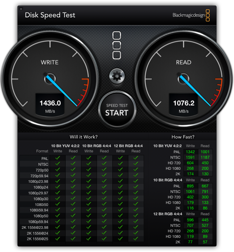

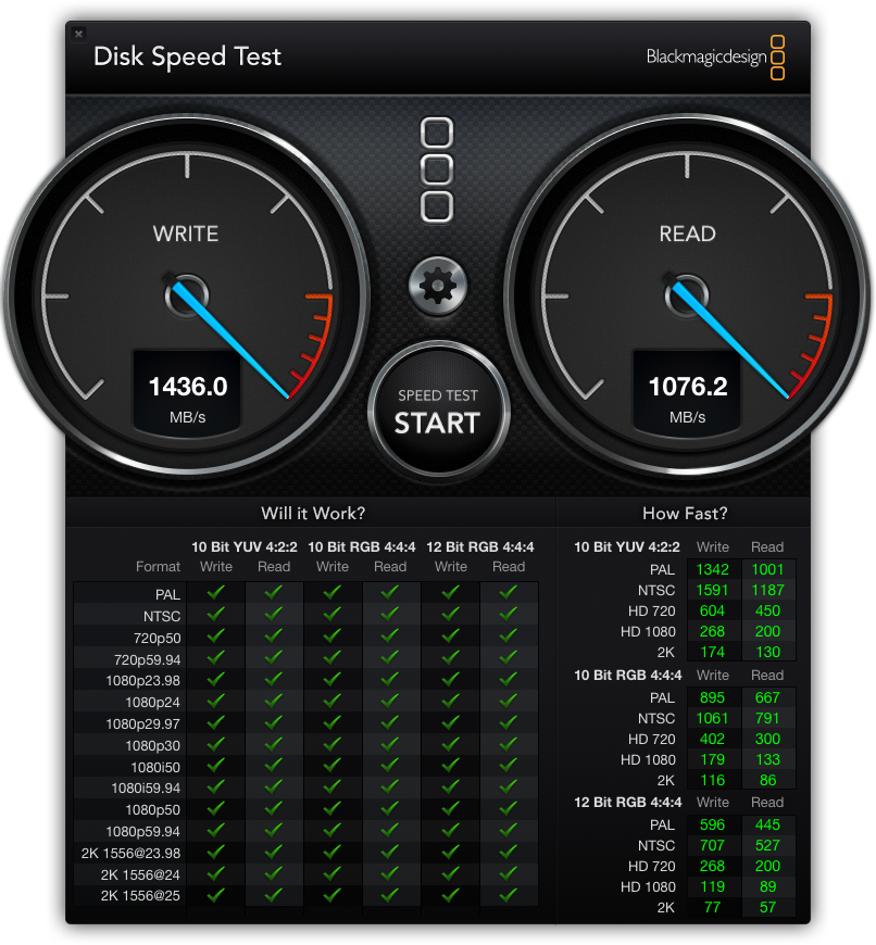

I am able to deal with 4K (R3D, Alexa, Sony, Panasonic etc) with Avid only because of a fast RAID (nonSSD).
