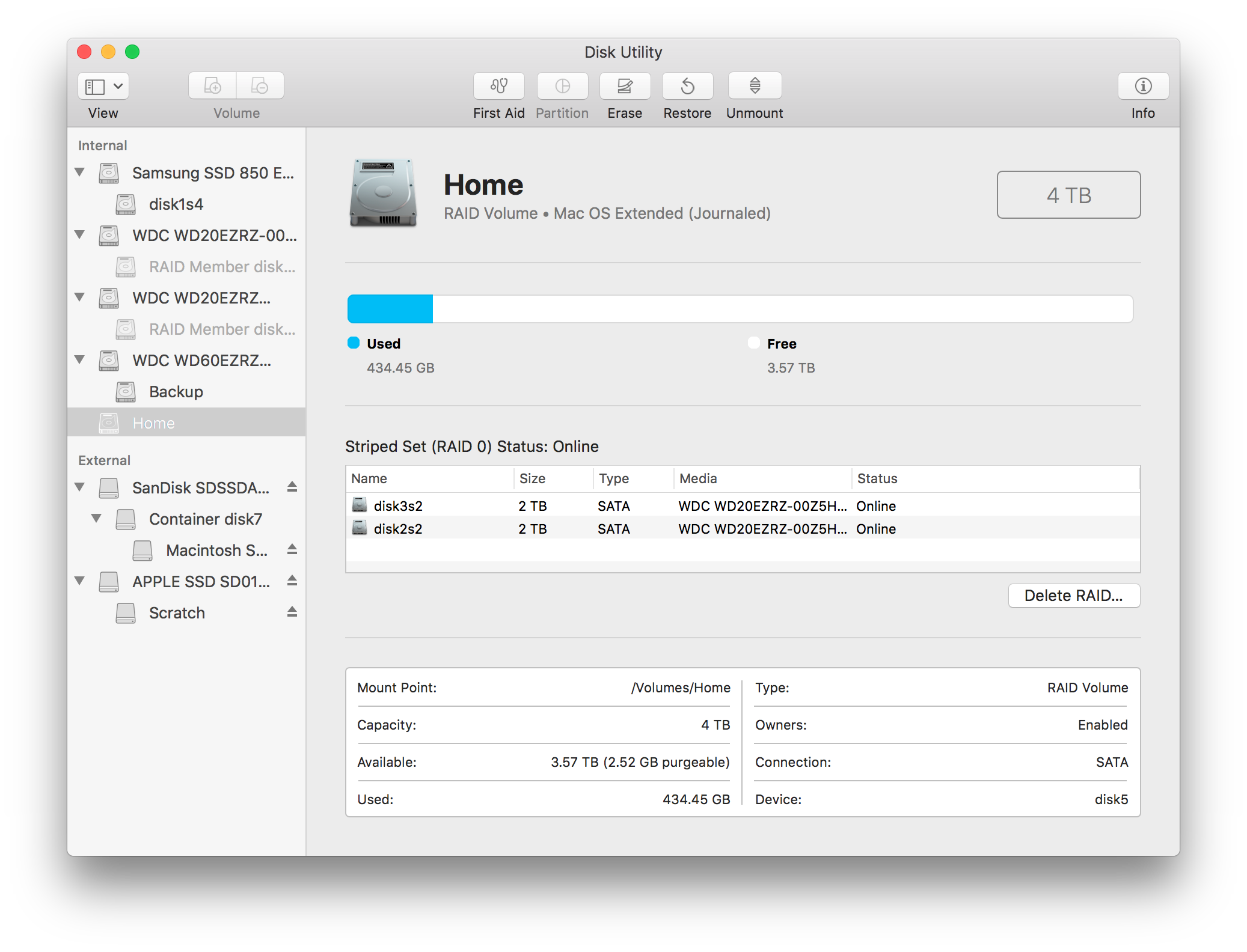

Thanks for the replies.
RAID.10 = a RAID.0 made from (2x HDDs in RAID.1) + (2x HDDS in RAID.1)
I've been using Terminal to setup/break RAIDs because the El Capitan Disk Utility couldn't.
https://www.tekrevue.com/tip/create-raid-el-capitan/
