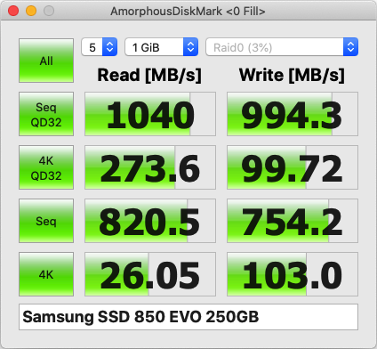

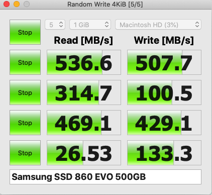

will definitely boost read/write performance while transferring large files, here's my 2012 13"MBP stock vs RAID0 APFS.

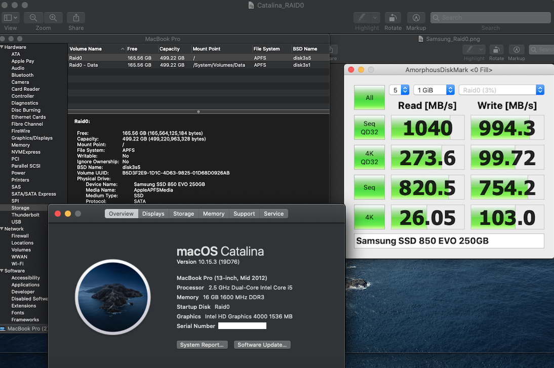

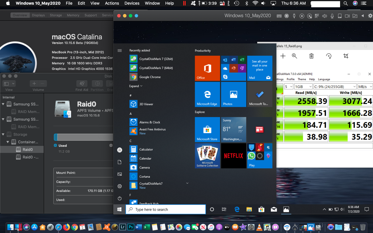

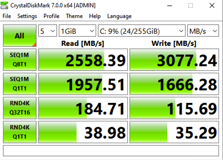

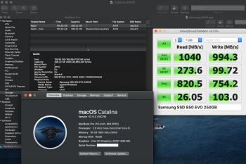

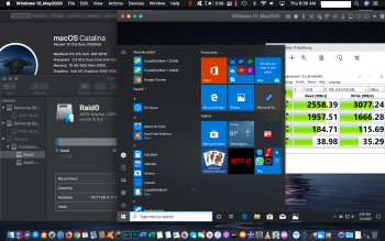

its been 2yrs now since I've setup my Mid 2012 9,1 Macbook pro with 2 SSD in a RAID0, pretty reliable imho, i do have a clone backup just in case, having Parallels 15 installed surprisingly pretty fast disk write and read performance in RAID0 compared to single SSD.

My advice, do it. You will absolutely see a performance benefit. Just be sure you have a solid cloning software to deploy it. Catalina will not allow you to install via the usual installer. The work around is to clone your current drive onto a pre-formatted raid array. I use SuperDuper, but CCC works well too. But you also need to know, doing this will also prevent you from updating the OS. Again that just means you'll have to use the cloning software again, update accordingly, then clone back to the raid. It is'nt the most elegant solution. But it works! And to those who say it increases your risk of a data loss... yeah no ****. But if you're savy enough to set this up, and invest in the drives, you know the deal. It'll pay off!
I've been running a similar setup on a Mid 2012 13" for two years. I have a 1tb 860 Evo, and a 2tb QVO. I partitioned the QVO into two partitions; 1tb for the Raid 0 array with the Evo, and 1tb for what I call "the update drive". This allows me to quickly manage updates on the regular partition, and clone to the raid array very quickly.
