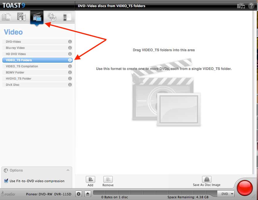

Ok the first question is if you are using the correct tab in Toast, as you should be using the "VIDEO_TS Folders" under the Video projects tab as per the attached illustration. You can then use the "Add" button at the bottom or you can drag your VIDEO_TS folder into the window, then click the red button at the bottom to begin.
The reason I ask this is that what you described sounded pretty odd, so I checked the MTR forums under Title Specific problems and there were not any real problems with your title with the current MTR 3.0 r14m so I have to wonder if Toast is being set up right.
