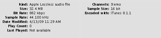

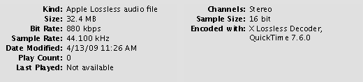

I convert a same song with the 2 methods! and they bring me 2 different results on BIT RATE (see the attachments, please)
XLD: 880 bitrate, 32.3mb
Toast > iTunes: 882 bitrate, 32.4mb
WHY the different, which is better??? why different bit rate and different size mb?

Both do the same job. Both will do a lossless conversion. So in both cases you will not lose any quality. What program you use is up to you. Personally, I use Max.
it seem not be the same, see the attachments... different size mb and bit rate! why??
With lossless files bit rate is not an indicator of audio quality.
Lossless is just that. If one setting makes for a smaller file it is because the software, with that setting spent more time looking for and encoding patterns.
With lossless, no matter what the setting, you will get back the same exact bits that went in. All lossless files formats have identical audio quality.
