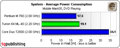

Hopefully, the difference in energy consumption between the Pentium M & Core Duo is negligible. However, some of the tests conducted by toms were a little disturbing.

Yeah that is a little disturbing, but what that review goes on to say is that the Core Duo(both proccessors) running at max only consumes 21watts.. that extra 17watt consumption is coming from somwhere else.
They go on to mention that it could from the 512mb graphics card or in their mind the more likely culprit is USB 2.0 conflict with the proccessor.. apprently they have been hearing rumors that there is a conflict that is causing extra power consumption with the Core Duo.
Anandtech also did a Core Duo review/preview and if their figures are anything to go by, the Core Duo system should be tying or slightly beating the previous generation Pentium M system at that clock speed (and note that a Core Duo at 2GHz is substantially faster than the previous generation Dothan chip at 2GHz). I wonder if there is a defect specific to the laptop model that Toms Hardware tested?
I think the Core Duo on that graph is the high voltage one used in the iMac. I read that the Macbook's at 1.67 and 1.87 gHz are low voltage.
