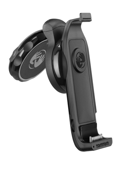

Ok my iphone 4 arrived today, went to put it in my TomTom car kit. It fits but would not connect to the bluetooth or charger. So instanly I got pissed off. Then decided to take a closer look. In order for the phone to connect to the car kit it needs to completly click in which it does but since it is thinner it is not allowing the docking port to rock all the way back. So I rolled a piece of paper and placed behind the iphone 4 and it worked. So I'm thinking they will come up with a fix in the near future, if not i can make a simple mod to fix it.

I just tried this method and it worked. I did get a warning saying that the device wasn't compatible and it only found it as "handsfree" under Bluetooth devices.
Can you explain what you mean by "just place the paper at the bottom"?
When I put mine, it fits, but does not power nor route the sound to Tom Tom Car kit.

At the bottom of the kit where the phone docks in and it pushes back into the device. Basically the bit of paper needs to hold that back. I put a folded bit of paper over the section first then put the phone in over it.
I sure hope that TomTom either comes up with an adapter for the existing model or comes out with a new version of the car kit for iPhone 4. These paper and Velcro workarounds are just not working for me.

My wife and I both have Tom Tom car kits and came out this morning to discover our wonderful new iPhone 4's did not work in the car kit. Please post a pic of the "rolled up paper" temporary fix... so I can visualize the fix.
It would be helpful if you could take a photo of the paper fix, I can't quite visualize the fix. Sorry...

Yeah...I tried the velcro trick that Engadget mentions. It doesn't work for me. Sigh...hopefully TomTom will get a permanent solution for this soon!

That little hack worked like a dream for me!.. Except I used a piece of rubber.. I don't understand how i doesn't work for some of you.. The idea is your pretty much compensating for the thin design of the iphone 4 by putting something between the phone and that rocker thingy that enables the kit to communicate with the dock.. If the velcro didn't work maybe it wasn't thick enough?
I have tried paper, velcro, rubber, and rubber bands with no results. The phone never indicates that it is charging and the TomTom app never recognizes docking or acquiring a gps signal. Fortunately, I still have time to return it to the Apple store.
