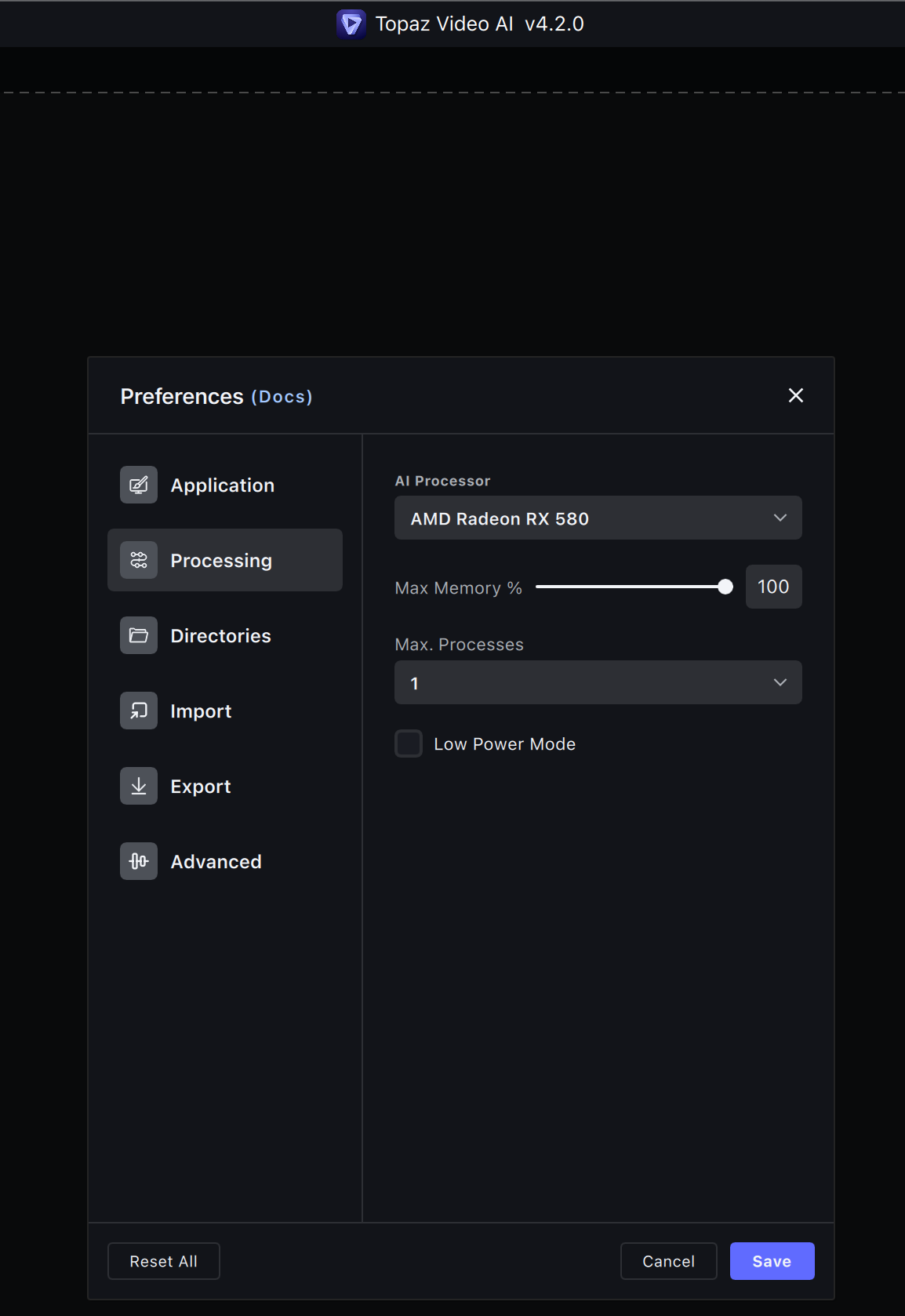

I downloaded Topaz Video AI v 4.2.0 several months ago to try it out and it worked fine. Now I see the requirements for Intel CPU must have AVX instructions, didn't see that before.
In preferences I can set GPU as the processor so why would I need AVX CPU?

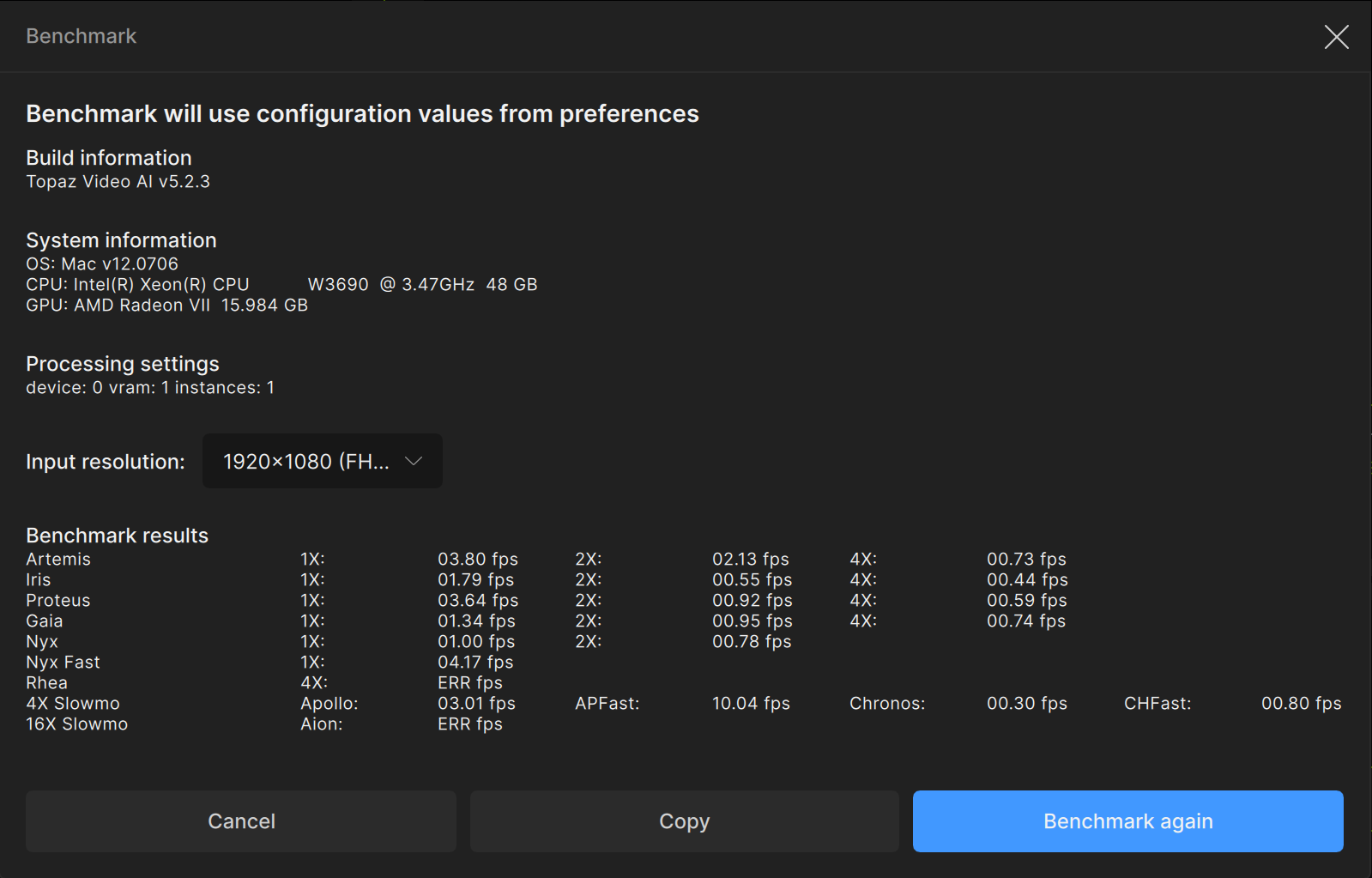

I have Topaz Video 5.2.3, do you want me to run any test for you?
I use Radeon VII to process the videos.

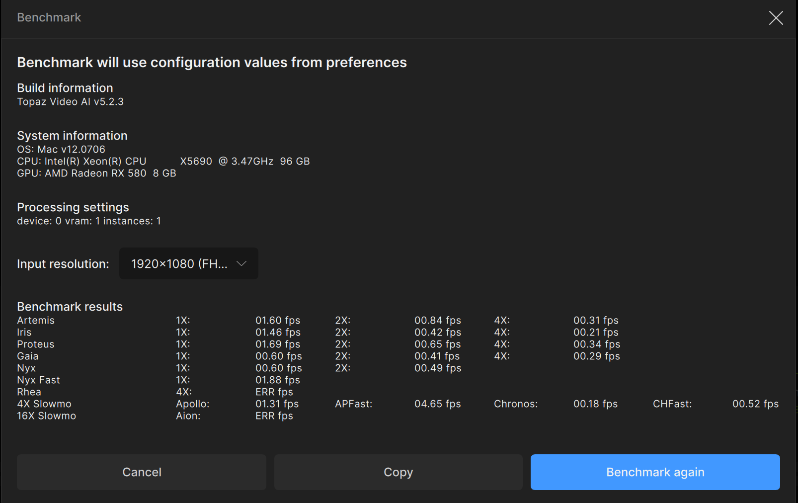

I installed 5.2.3 and it does work on my cMP but I have clearly reached the limits of the RX 580. I'll upload the benchmarks when it finishes to show what I mean.Screen Shot 2024-08-14 at 11.23.51 AM.png
Although not the results I was hoping for, it does work on my cMP. The benchmarks from high-end GPU's posted in the Topaz forums shows the limits of the RX 580 for sure.

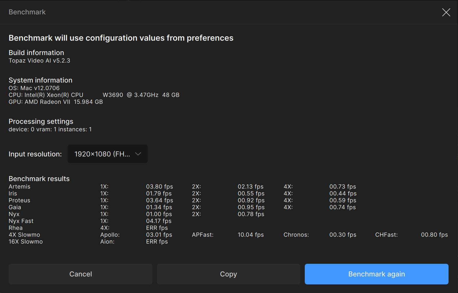

I just ran the benchmark, and confirmed that most of the numbers are GPU limiting. Which should be a good news for us. The GPU is upgradable on cMP.

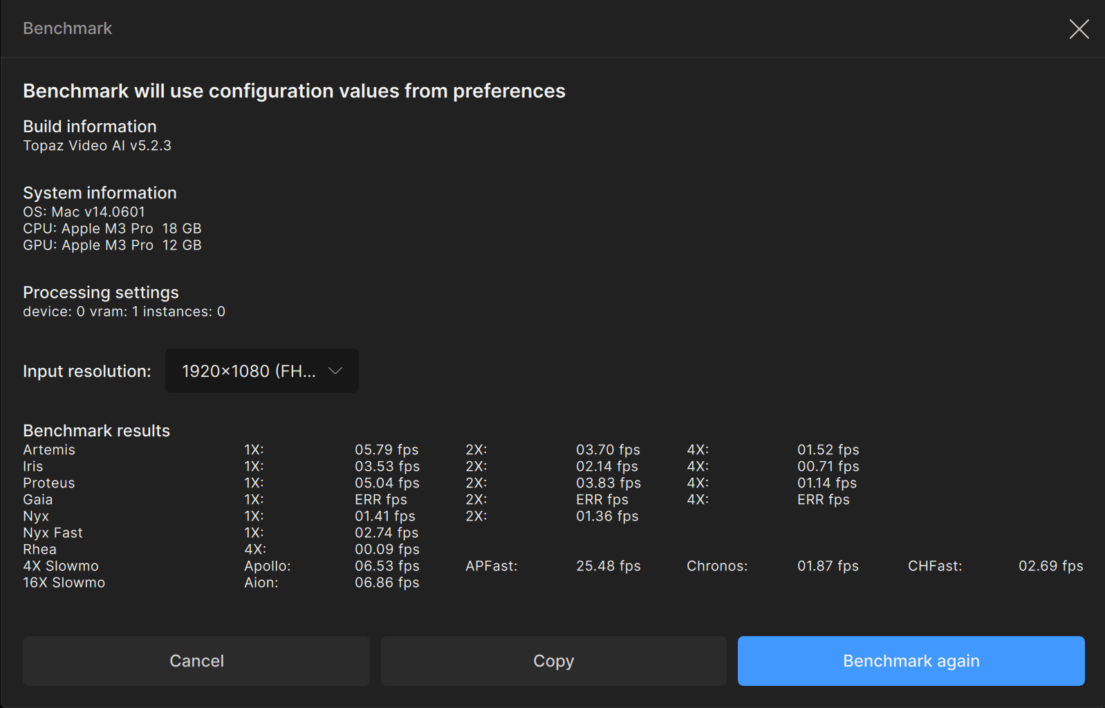

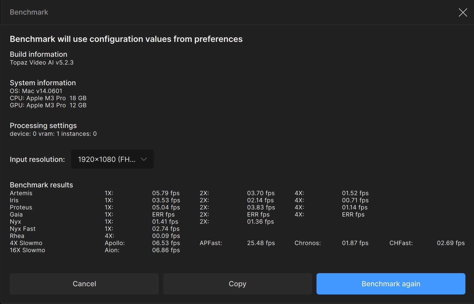

For info, those ERR items may not be AVX related. My M3 Pro has no AVX either, and show ERR on some other filters. (P.S. The benchmark on M3 Pro was run by the Neural Engine as per default settings, not GPU)

Yes, that is good news for us but I had not planned on a Pixlas Mod for this machine but that's the only way I'm going to get better results. The Benchmarking errors have been reported in Topaz "Bugs and Issues" by both Windows and Mac users. Scanning the forums, I don't think it has ever been resolved and I don't know if non-AVX CPUs are the only one's having issues? The issues date back over a year ago with version 3.2.0 to as recent as just a few months ago in version 5.

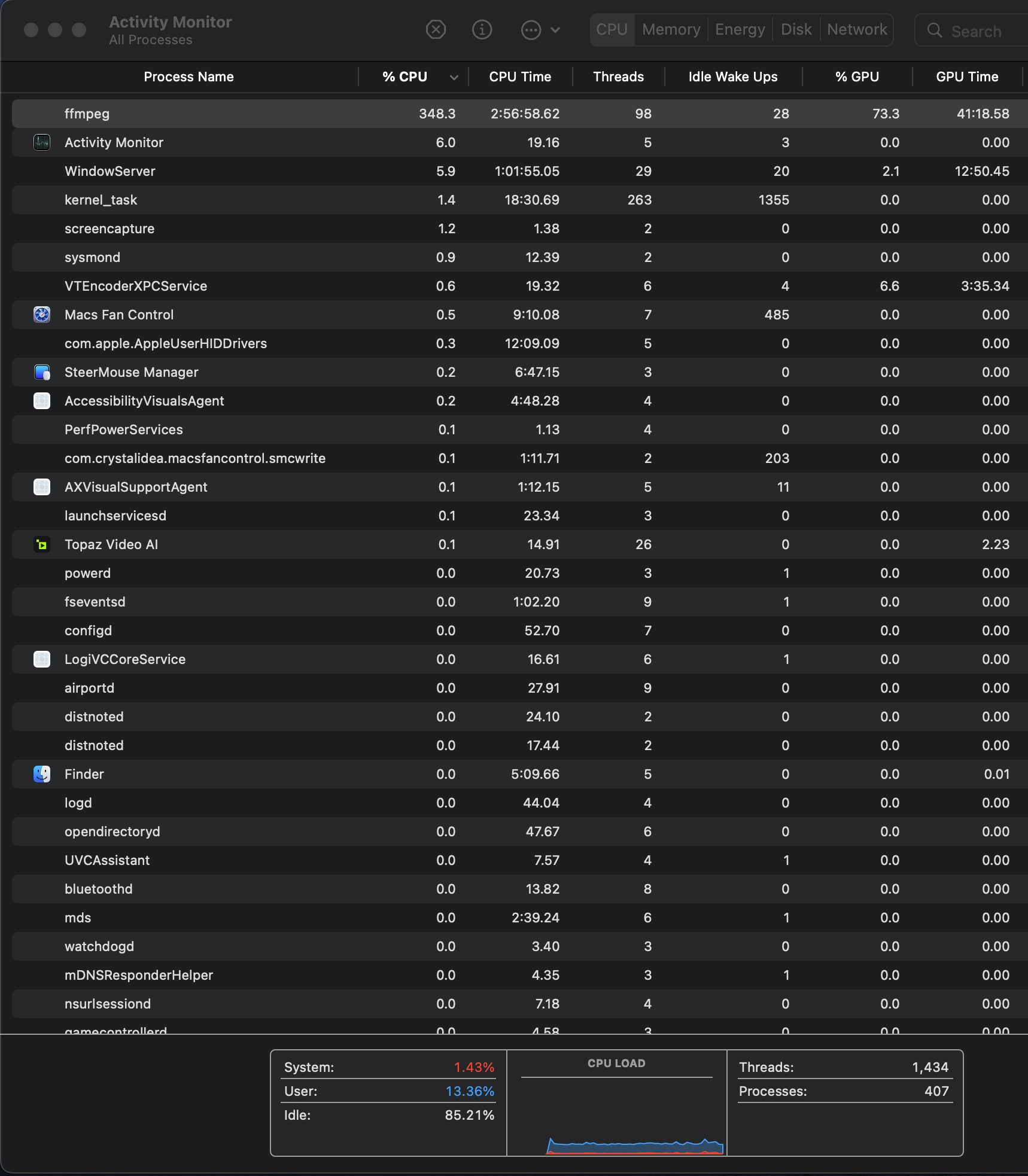

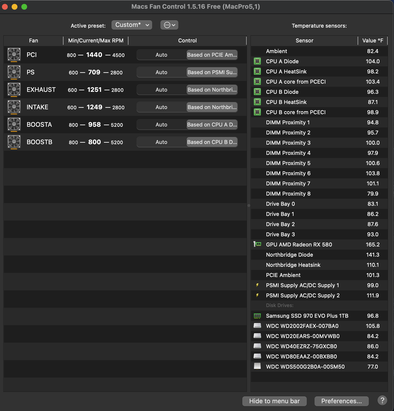

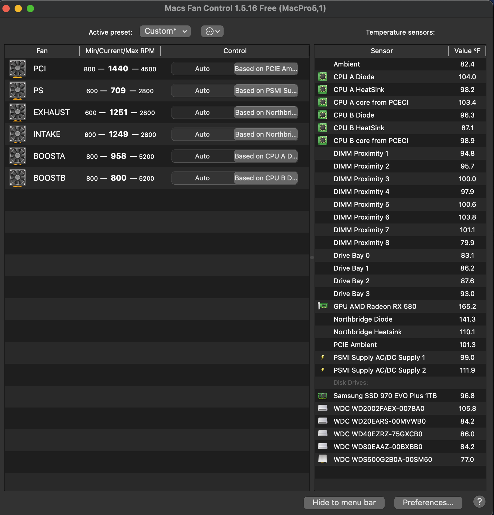

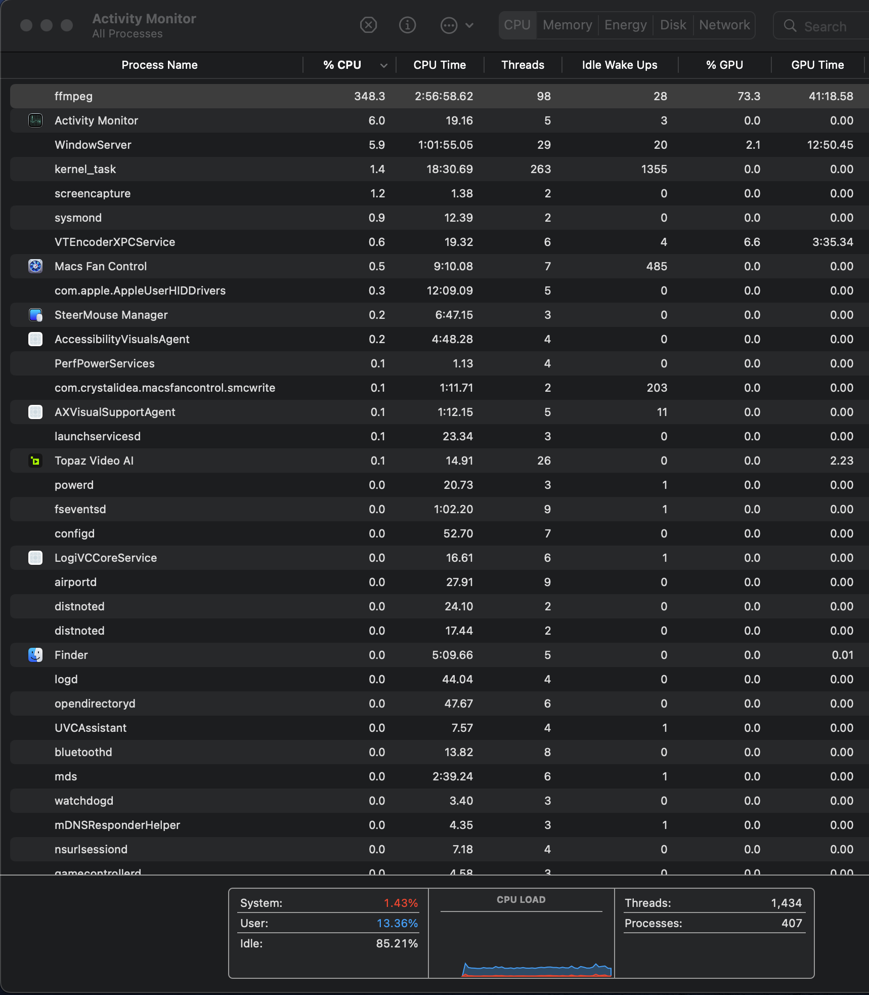

Temps are within range even while upscaling from 480p to 4K. Only taxing 4 cores out of 12 so plenty of cores to multitask that doesn't require GPU.
Final Analysis:
Dual CPU cMPs are capable of running v5.2.3 but is GPU dependent.
Single CPU systems will struggle, recommend 6 cores.
Video AI 5.2.3 shows no adverse effects when running on cMP.
Screen Shot 2024-08-15 at 11.49.50 AM.pngScreen Shot 2024-08-15 at 12.02.19 PM.png
NOTE: Temps are shown in Fahrenheit, not Celsius.

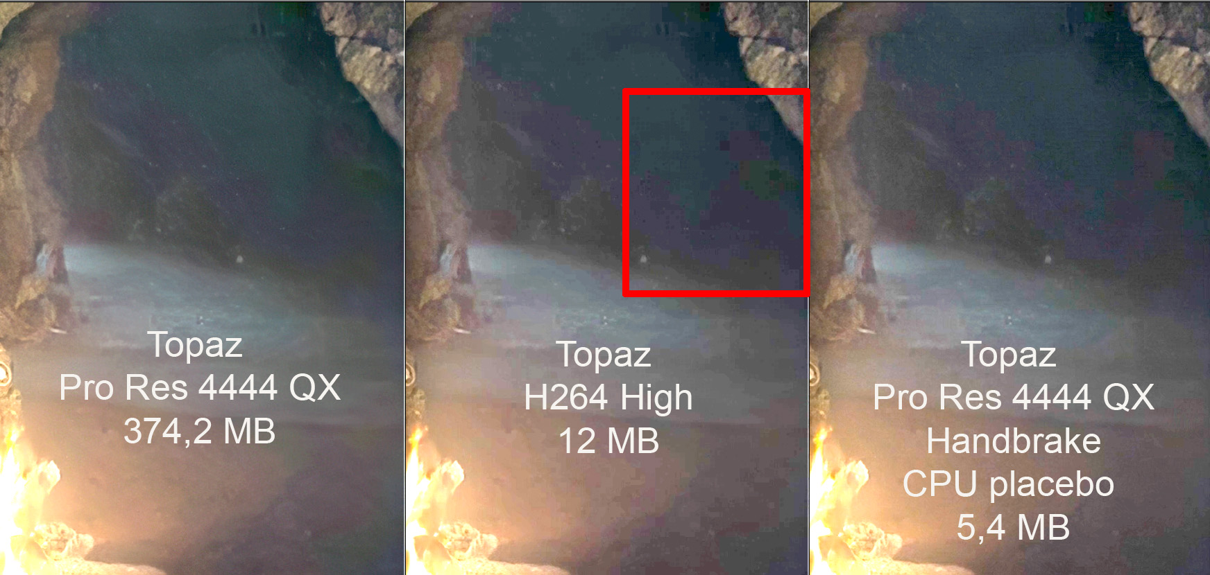

I will use Apple Pro Res and then use Handbrake to get the best quality to size. If I use mp4 direct in Topaz, the quality is significantly worse.
Curious - what settings in Topaz made it worse for you? The results I get seem pretty good except for the file size.
When using H264 High, I will get more "blocks" in dark scenes or gradients.
I have pitched up the gamma to show it better
