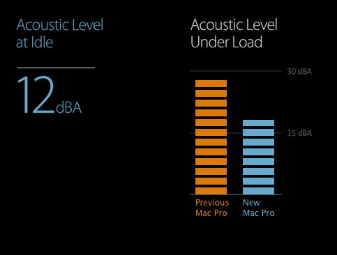

fwiw, apple has a promo page dedicated to just the fan. they have said one of the design targets was to match the mac mini's noise levels.
from the mac pro page
An incredible amount of innovation went into designing a fan system capable of cooling such a high-performance device. Instead of adding extra fans, we engineered a single, larger fan that pulls air upward through a bottom intake. As air passes vertically through the center of the device, it absorbs heat and carries it out the top. It’s simple and elegant — and also astonishingly quiet. To achieve that, we had to consider every detail: the number of blades, the size of the blades, the spacing of the blades, and even the shape of the blades. By minimizing air resistance throughout the system, we were able to design a fan with backward-curved impeller blades that runs at fewer revolutions per minute, draws air more efficiently as it spins, and creates considerably less noise.

Flat five beat me to it with a picture. The numbers given were at load based on the graph found on the ninth 'dot' in the Mac Pro overview page (6.5 bars on the graph to hit 15dBA).
