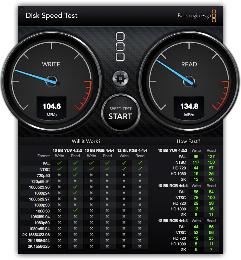

I just wanted to warn others about the Toshiba Q series SSDs. If your MacBook/MacBook Pro uses the Nvidia MCP79 chipset, the Toshiba SSD will run at SATA 1 speeds (negotiated link speed of 1.5 gigabits) even though the computer is capable of SATA 2. This results in dismal speeds of about 105MB/s writes and 130MB/s reads when it should be double that.
Calls and emails to Toshiba asking for a firmware update to correct this have proven to be useless.

You didn't by chance put it in the Optibay did you? Because that would be the expected behavior in that machine if so.

Kingston SSDNow does the same sometimes, I stick to Crucial and Samsung to go in MBP's for upgrades.

MacBook Pro's are finicky SSD wise, even more so when putting them and spinners in the optibay's where SATA 3 handshake issues crop up and you have to set the firmware on the drive to run SATA 2 only.

Pastrychef - I think I'm having the same problem as you. I purchased a 128 GB Toshiba Q Series Pro. I ran the BlackMagic Speed test and I'm not sure I know enough to check what version of SATA is being utilized.
I have a MBP 13 inch Mid 2010 with Nvidia MCP89. System information reports the negotiated speed at 3 gigabits. The speed seems to vary but I'm getting as fast as 200 MB/s write and 260 read, but its not consistent. I was expecting a bit faster since the drive is supposed to read at above 500...
Any thoughts for me??
The speed will give you a guide:
SATA1 = circa 100-150MB/s
SATA2 = circa 250-300MB/s
SATA3 = circa 450-500MB/s
To tell though, go to About this Mac, More Info, System Report and click on SATA/SATA Express, click on the "Intel 6 series chipset" and look for "Link Speed" and "Negotiated Link Speed"
SATA1 = 1.5Gb/s
SATA2 = 3.0Gb/s
SATA3 = 6.0Gb/s
If your Link Speed is 6 but Negotiated Link Speed is 3 then your chipset support SATA3 but the drive is running at SATA2 for some reason (either it is a SATA2 drive or is encountering errors at SATA3 speed for instance).
HTH
