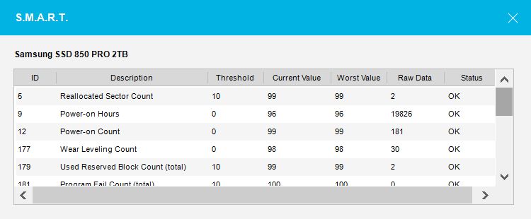

If the system has the original hard drive you may be able to get an idea from the S.M.A.R.T. "Start/Stop Count" and "Power-On Hours" metrics. I'm unsure if this would work for SSD equipped systems.

"power on hours" is a S.M.A.R.T. feature, try that.

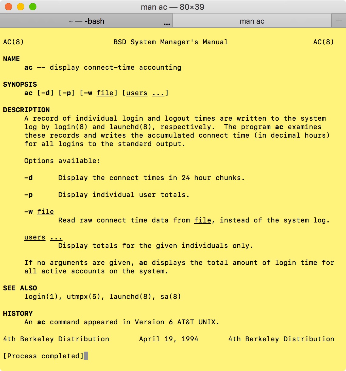

This "ac" command is not really the total up time. e.g. In my case, it only shows 4732 hours. But my cMP basically ON 24/7 since 2009. That's too far away from the real accumulated system up time.

Edit: as above, seeing accounting information when command run as root or via sudo. Also getting a number that does seem low for my machine and usage.
The various log files in the system do roll over, so, no master file with every startup/shutdown recorded in it, probably.

If you still have the original, you can stick it in any system and get the S.M.A.R.T. data. Could even be a Windows or Linux system - as long as it's not completely dead the data can be read.

But if the old disk was the original system disk, and they're on the second system disk - the sum of the two times would be the computer's total. As long as you have all of the system disks, you can get the computer's total.
