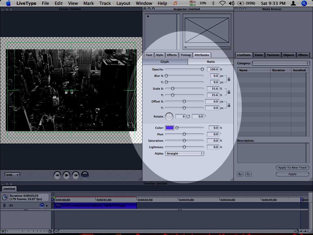

I don't think you really need to use photoshop at all (if I understand what you're trying to do)...LiveType has some decent features to control image attributes. Just File->Place the image, then play with it till it looks right.
WOW. I haven't tried using that, only the Size bar at the first window. But yes, it do makes the job for what I want.
Another doubt, I see that in your picture, you only put the photo just slightly outside of the Action Safe area. Is this area the maximum that any widescreen TV can show?
I haven't been able to understand this completely, it's just my third day with FCE and Photoshop and I am having a hard time getting used to it.🙂
I just tossed my image in there with no real regard to position/sizing, just so I could verify that the features were there for you to use and would work right.
The title/action safe areas are guides/suggestions for optimal display on all televisions. The action safe area covers 15% of the view on each side, title safe 30%. These are there because certain televisions (usually tube-style models) will 'overscan' and crop the edges off of the television image, so there are recommendations for how much distance from the edge you should have for titles (text on the screen) and for action (other stuff in the frame).
Working with the guides is a good idea so that your stuff will be portable and look right anywhere. 🙂
