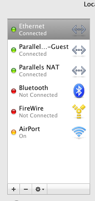

Only Hard drives and DVD's etc. are shown on the desktop. To check to see that you are connected try this:
1. Open the System Preferences
2. Click the "Network" Preference
3. If the Ethernet cable and the Router are connected correctly you should see a green dot next to the words "Ethernet".
If the dot is orange or red than that means the problem may be with your router and you should make sure that all is connected correctly.:apple:

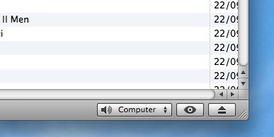

To eject, without having to reboot use itunes, just click the eject icon that is displayed in the bottom right of the itunes window. Any time I have had a problem rejecting it does the trick.
