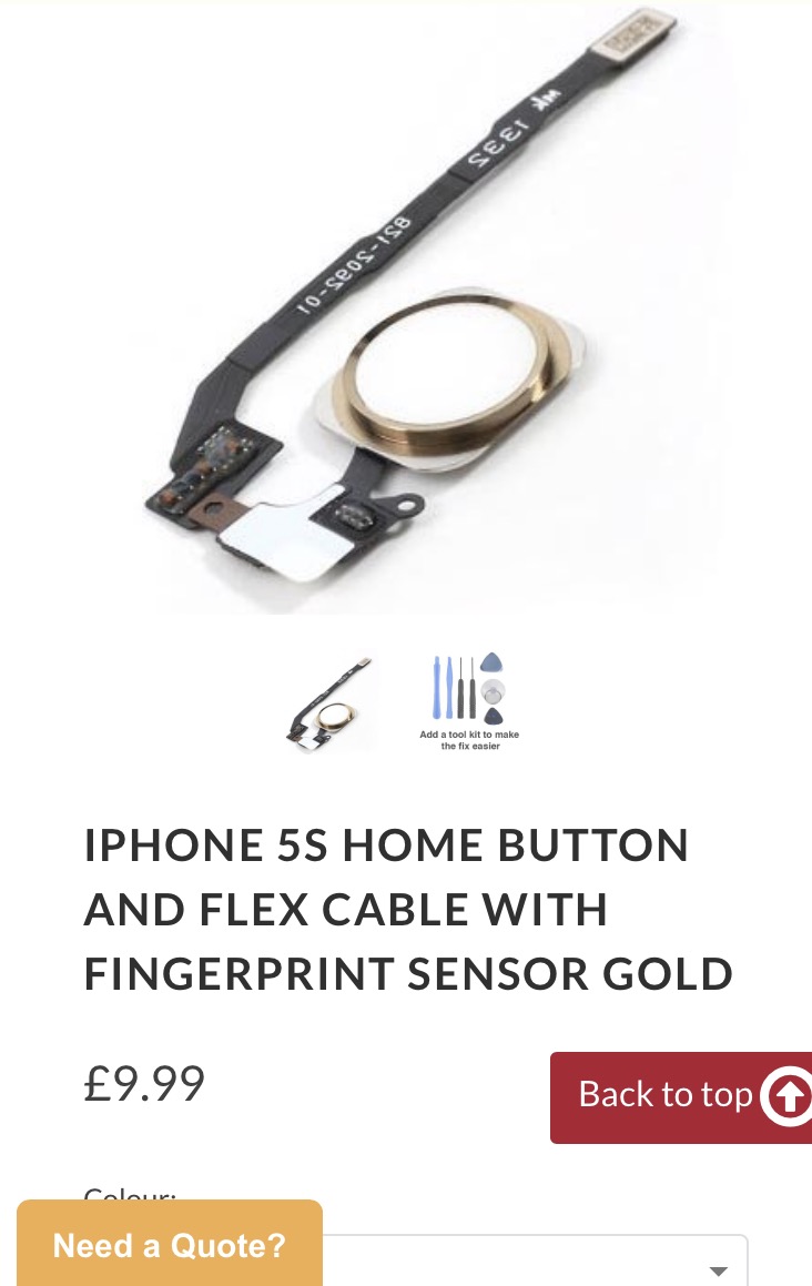

You need this part I reckon
Not too expensive either
Have ordered a new home button assembly to see if this makes a difference but I suspect it won't. My research shows it is the phone trying to monitor the fingerprint reader but can't as the button has been replaced. This loop cause the drain. Being synical I suspect Apple do it deliberately like the error 53 on the later phones to stop third parties repairs.
