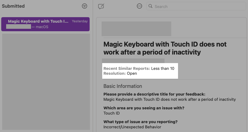

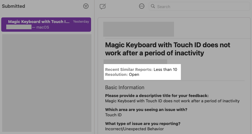

If everyone could please report the issue with the Feedback Assistant, it will get this on their radar much quicker. Right now it shows that less than 10 recent similar reports were filed. We can do better than that!
I tried to give feedback on this, but I couldn't find the Magic Keyboard on the feedback page.

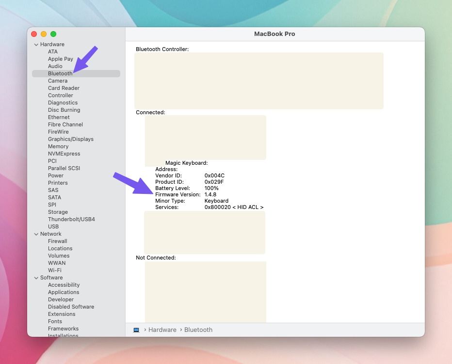

Can you please open System Information, go to the Bluetooth section, and tell me what Product ID and Firmware Version your Magic Keyboard has?
Anyone else experiencing this issue, can you also do the same? Perhaps we got a secret update...

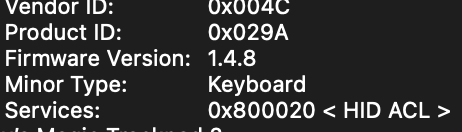

Edit: Looks like version 1.4.8 is fairly old, I found a post dating back to June 14, 2023 where someone says they have this version: https://discussions.apple.com/thread/254914293?answerId=259170550022#259170550022
But of course I am assuming that this is a firmware bug in the keyboard and not a software bug in MacOS.

I'm not on the Sonoma beta anymore (now on Sonoma 14.0 build 23a344) and the keyboard is also on the same 1.4.8 version

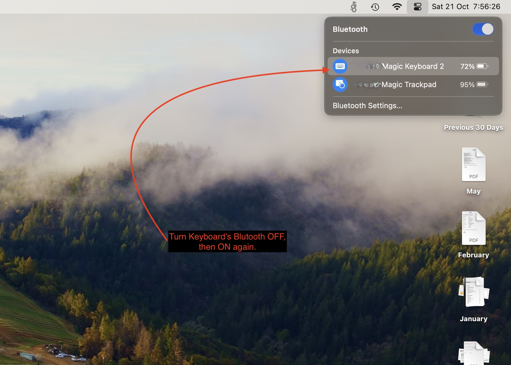

AppleCare replaced my faulty Magic Keyboard after I had liquid-damaged it, but my new keyboard encountered the same TouchID issues reported in this thread: all keys work, except TouchID on Bluetooth. It was flaky: TouchID would start working, then after a few minutes, it'd stop. It works flawlessly when wired though.
This carried on for a couple of weeks until I started disconnecting, and reconnecting the MK's BlueTooth connection via the Control Centre. Did this a few times, and now MK works as it should, perfectly, TouchID via BlueTooth and all.
Same here. Touch ID has now been working on my M2 Mac mini for over 2 days now. I am not on beta - 14.0 (23A344) and the keyboard is also on 1.4.8 version
