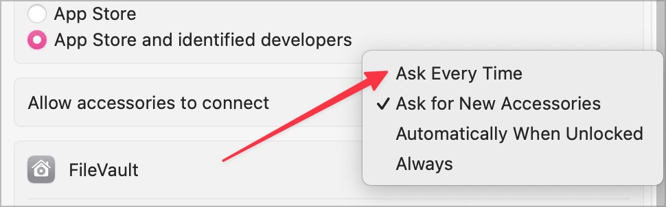

I wonder if at some stage the setting for "allow accessory to connect" has been stored in a way that makes Sonoma believe there is a security risk and therefore disables Touch ID. Perhaps try flipping the System Setting to "ask every time", try connecting your display and confirm the prompt, and then see if Touch ID is operational?
