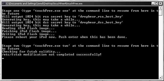

Can anyone help me out? While running touchfree.exe, it gets to reading ipod flash image then to patching ipod flash image. but then after that i receive an error message from windows and it closes the process. any pointers?
Yep, I get the same thing.
I have followed the instructions down to a T.
Running XP 2000
Moves iTunesmobiledevice.dll to same folder as touchfree.exe
Restored my iPod
Yes, I have .NET Framwork 2.0 installed
Yes, I visited http://jailbreak.toc2rta.com on my ipod and safari did crash.
Ran touchfree.exe and I got up to 'patching ipod flash image' and then got a error mesage and the program crashed
Any ideas how to get this fixed? 🙁
Chris.
Chris.
How much time did it spend on reading the iPod flash image? Do you have a 300 MB file called rdisk0s1 in the same directory now?
One more question. Are you using firmware version 1.1.1 or the one that came with the iPod?

Being, do you know why this error occurs? It happens while patching the ipod, and it happens immediately.
