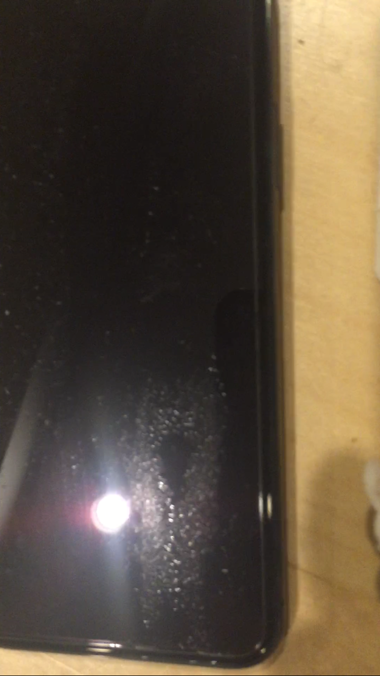

I thought all the screen protectors are the same. I’m clearly wrong. There was several problems with the maxboost. The oleophobic layer was terrible and uneven, parts of the glass felt gritty and not smooth. The cut is too narrow so you see rainbow on the sides. Anker is about 1mm over the screen edge, so all rainbows gone. And lastly, maxboost says 25 mm thickness which I highly doubt, most likely twice that. The loss of sensitivity was surprising. Never had issues before but with maxboost, the screen wouldn’t scroll properly or erratically unless I put a little more pressure. Like the previous poster, some keys wouldn’t register until I tried a few times. Don’t cheap out on screen protectors, there is a difference. You get exactly what you paid for.
Love the new anker karapax protecters. Came with a template and made install so easy. The glass is much more smoother and responsive. Also the anker is very glossy so it really gives the phone a new shiny look like the original. The older one I had with the 6s plus had taper edges, too bad it’s not on the new ones. Oh well. I ended up spending twice as much cheaping out then having to buy a new set and redoing everything. Don’t make that mistake. Your $1000 phone deserves better.
Pics of anker screen protector and pic of maxboost screen protector with oleophobic defect. I rubbed it with a wet tissue and the flaw became clear as day.
