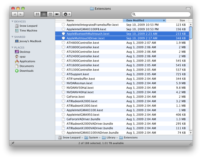

Wanna try an experiment? Check this out.
Move these 2 highlighted files to the Desktop, then delete them from the Extensions folder.
Then restart.
The mouse should be nice and fast again!
Then restart.
I already tried it.

It didn't harm anything. I put them back after and it's back to normal.
The worst you'd have to do is download the Magic Mouse driver again from Apple.com.
It was just interesting how much better the cursor felt after removing those 2 files.
Maybe I'm missing something, but how would removing two files, and then just replacing the same two files again fix anything?
Removing them shows that the cursor speeds up, but you lose the ability to scroll. Replacing them slows down your cursor again, but you gain scrolling ability. It was just an experiment to show that it's not the mouse, it's the drivers.

1- Delete the files AppleMultitouchDriver.kext and AppleBluetoothMultitouch.kext from 'MacHd\system\library\extensions'
2- Restart
3- Install apple wireless mouse update 1.0 (can be download from apple's website)
4- Restart
5- It should be perfect now but do install the free MagicPrefs should you need extra tracking speed.
I hope this helps as it did for me.

I don't know if you're being sarcastic or not, but did you see my screenshot?
Did you try it?
Did it work for you?
I tried it, but when i follow your steps and pugt back the files my mouse doesn' t work properly anymore!!. Where do i find the latest magic mouse software (cant find it anywhere) ( the update doesn' t work cuz it says i already have the newest software...
Mybe uninstall the existing software but how???
kext
You can use Kext Helper app to install your kext. It worked for me with both files you mentioned. I did not have to restore Snow Leopard.
