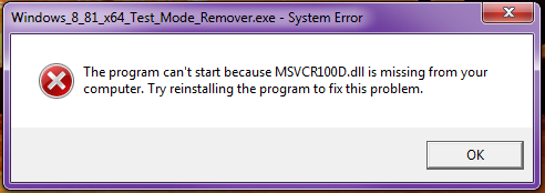

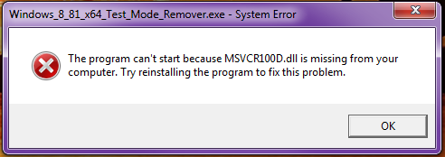

"Test Mode" back...
A recent Win 7 update has brought the "Test Mode" watermark back again. When I try to launch the utility to re-hide it, I get the attached dialog message.
Is there another, newer procedure to fix this?
Thanks,
- Chip
@Chip Moody: The mentioned .dll file is included in the fix archive posted in this thread (there are two files in the archive, .exe and .dll). I think you saved only .exe file after initially unpacking the archive, and ignored the .dll file.

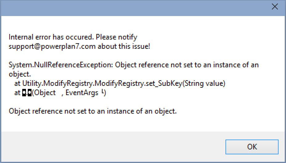

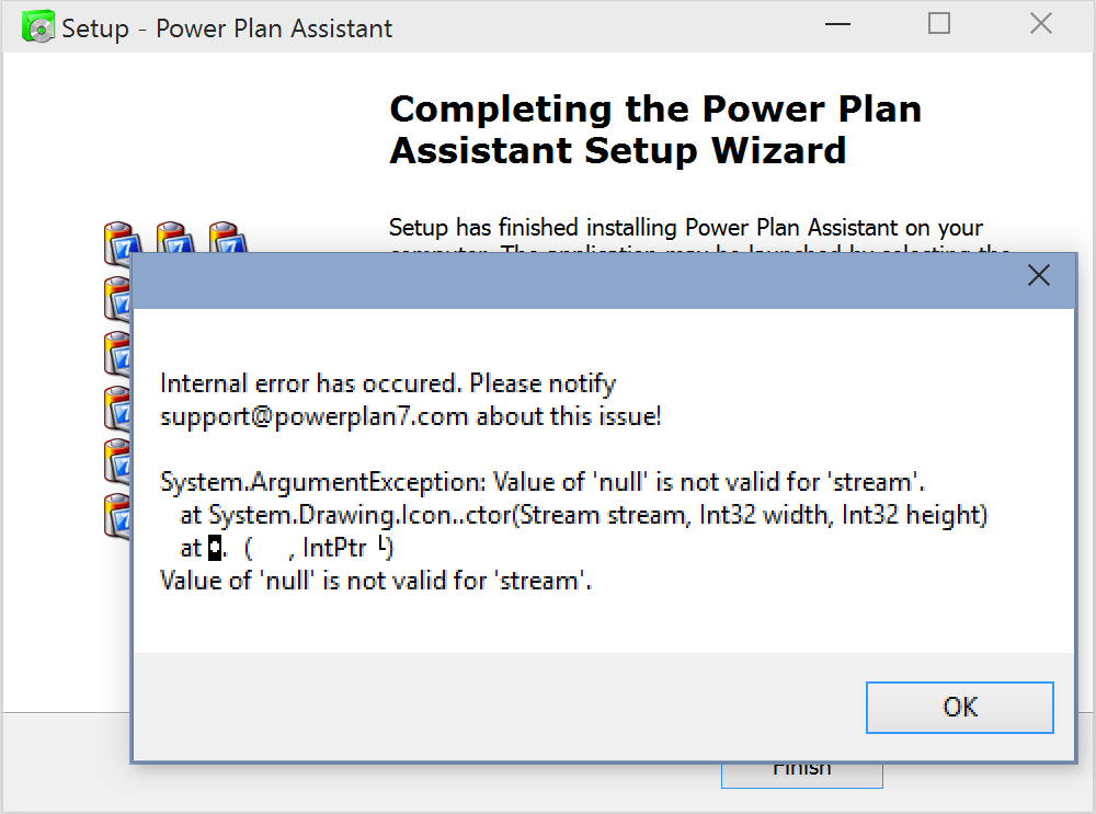

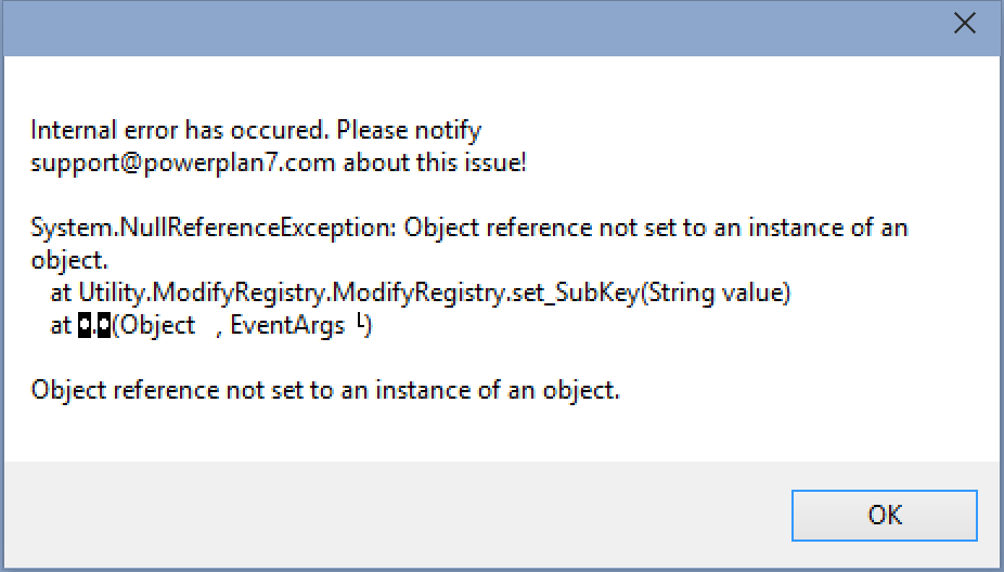

There are the following issues with x64 9926 Pro on MacbookPro10.2.
1. Powerplan tries to install OpenCandy PUP (blocked by Malwarebytes).
2. Powerplan gives error below left on install.
3. Powerplan when installed, after reboot keyboard and mouse stop working at all - I needed to repair windows.
4. After fixing windows and rebooting the other error (on right) is received when Powerplan starts:
5. After installing Trackpad++ it seems to work OK however scrolling is very jerky (compared to 5.1 bootcamp drivers)
6. Uninstall leaves "PowerPlanAssistant" in the "Program Files" directory and tasks for both PowerPlan and Trackpad++ in task scheduler.

About the Power Plan Assistant and Windows 10 build 9926: installs fine for me, no errors, no warnings. If somebody else is receiving the error messages, please email them to me for further analysis.
