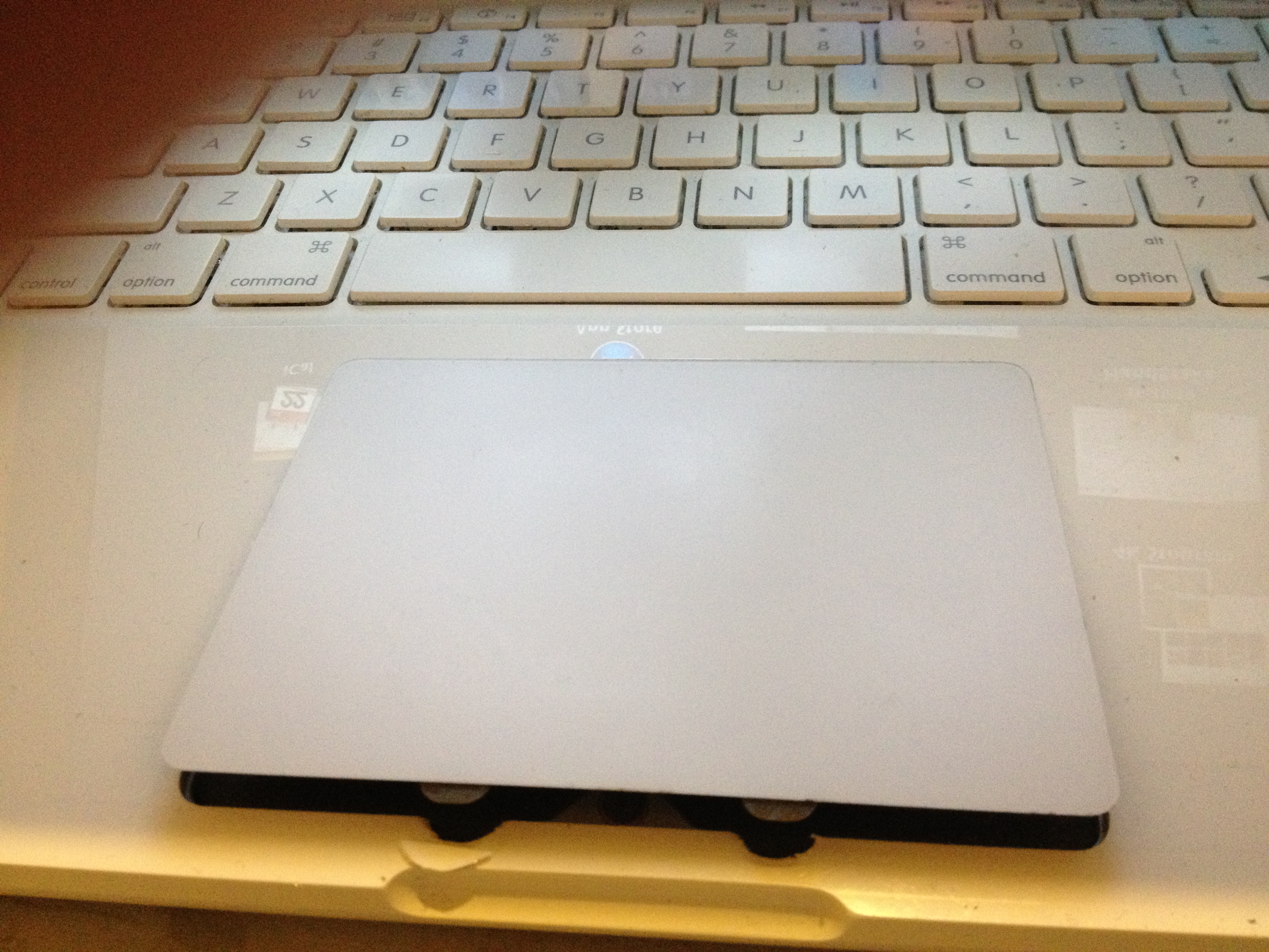

I had a 2010 white MacBook in which the battery swelled. It became so bad that the battery actually pushed the trackpad up breaking palm rests on each side making the trackpad stick up a half inch easily. The trackpad no longer worked. I was able to stick a pin in the pouch containing the battery to get the swelling to go down but once I did that, the OS began saying the battery needed to be serviced. I posted pictures of the damage last year in this forum.
The OP should replace the battery soon before it pushes the trackpad up damaging the case which will then need to be replaced as well. I ended up accidentally shattering the display on mine a short while after and just trashed the MacBook.
