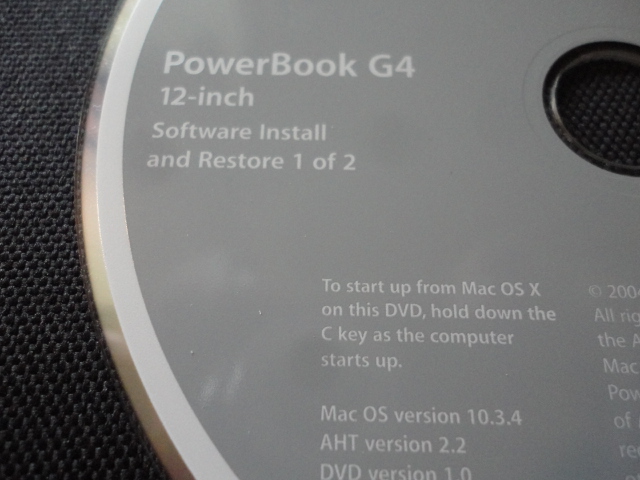

Will this restore CD work on my PB G4 12" 1.5 GHz ? Everything else is functional except the TrackPad. Stuffing a USB mouse in my pocket when ambulatory is uncomfortable.
I bought this PB on ebay and replaced the logic board, but never knew if the trackpad ever worked. I'm assuming the extra hard drive I installed was pre-loaded from another 12" Powerbook I had laying around. Don't want to reboot with the wrong CD recovery disk. Any suggestions ?
Thanks

Hard to say. Don't believe that's it, though. Yours shipped starting with 10.3.7. Couldn't hurt to try.
