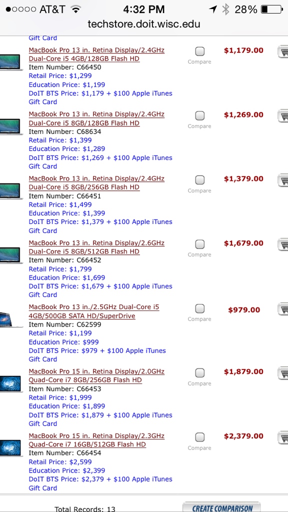

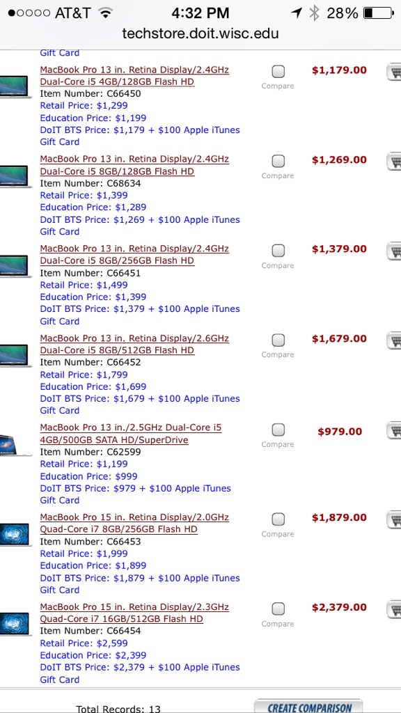

This is the pricing I can get through school. Doesn't apple typically release new models around now? ImageUploadedByTapatalk1406410418.084390.jpg

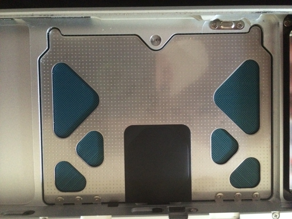

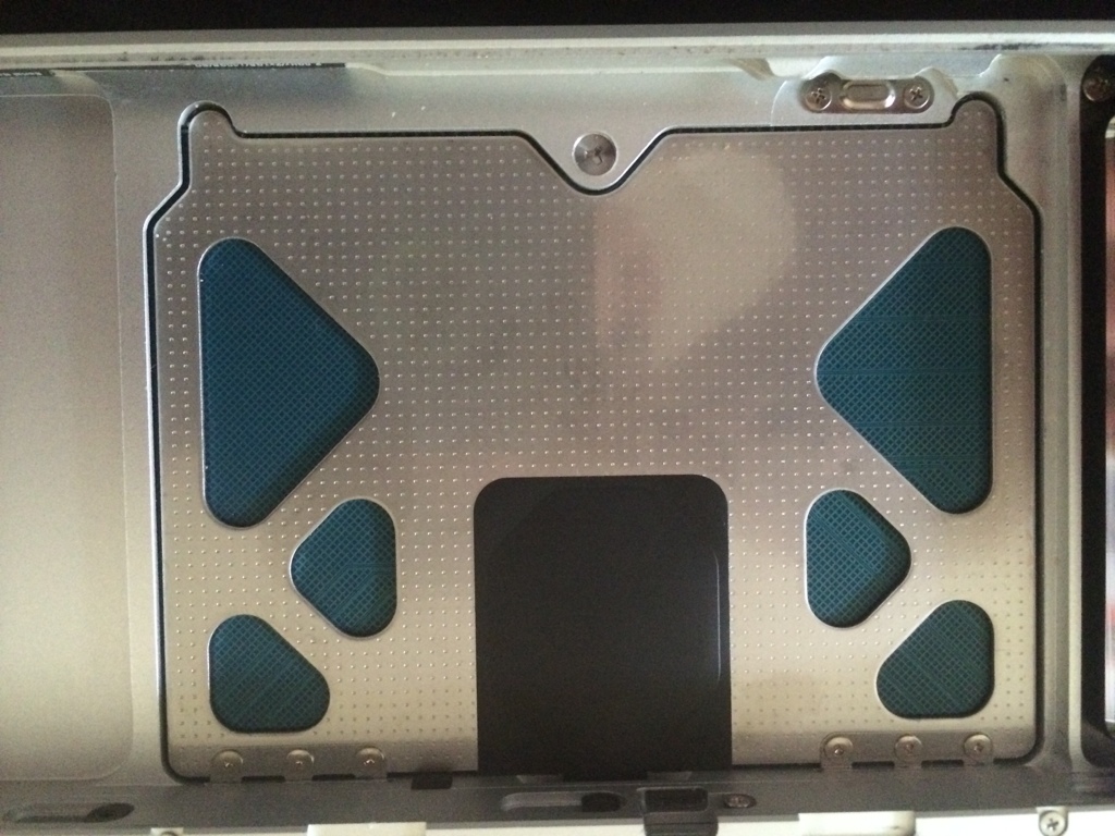

I just pulled it apart and wouldn't it just be a matter of pulling the screws and unplugging it? Mine doesn't look the same as the one in that DIY. ImageUploadedByTapatalk1406481739.967111.jpg
I just pulled it apart and wouldn't it just be a matter of pulling the screws and unplugging it? Mine doesn't look the same as the one in that DIY. View attachment 482624
The iFixit guide is a dream to work with. Try to get parts from iFixit or PowerBookMedic if they stock it. PBMedic has a great utility for finding parts that you just need your serial number for.
Yeah I've been looking on there and can't find one for my macbook. Mine is a bit different from the DIY. That's a great price on that trackpad though! I just got home from my cottage and documented the problems I'm having.
