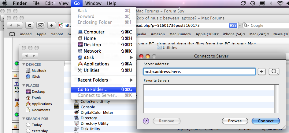

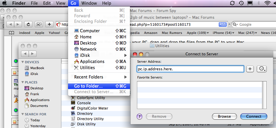

Connect both computers with the ethernet cable and use the Mac's ability to connect to the pc.
In the Finder use the "Connect to Server..." or " Go to Folder"enter the pc's ip address or the folder location there and you may see a Finder Window with the PC content.
Also you may see the PC in the Network.
