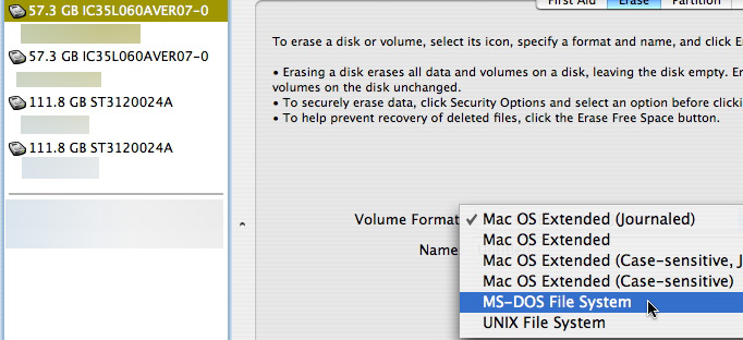

CommonMan said:
If I remember correctly the Mac Disk utility only gave me 3 or 4 options when formatting – one of which was Unix.
Don't click on the name of the HD, click on the hard drive info above it.
Then the option to erase it as MS-DOS (FAT) shows up.
