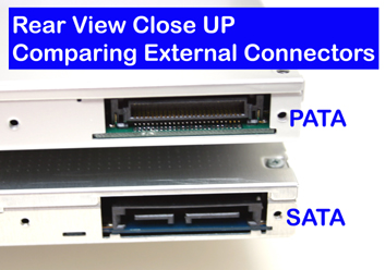

The MacBook Pro and MacBook use an S-ATA interface.
The following shows an S-ATA interface (bottom) and an IDE/P-ATA notebook interface (top):

IDE and P-ATA are the same. If your wife has/had a MacBook, it is S-ATA, if your wife has/had an iBook, it is IDE / P-ATA.
Both HDD are for laptop size. I am looking at a connector that would allow me to get the new HDD internal drive plugged into the IDE connector.
I need something very slim to fit into the laptop . Does it exists ?
A 40-pin P-ATA to S-ATA adapter exists, but as they are "big" (due to converting the signal), there will probably be not one you can use.
