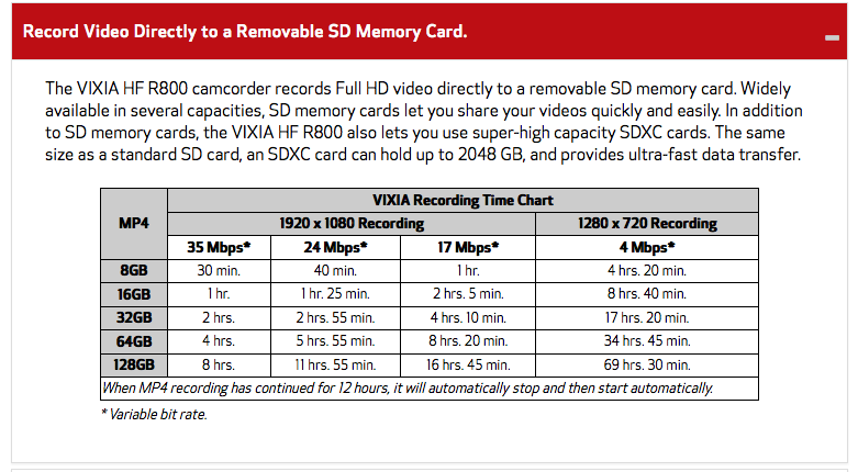

Did you check the link?
When I visit the link you provided and scroll down, I see an expandable item that says:
Record Video Directly to a Removable SD Memory Card
When I expand it, I see this:

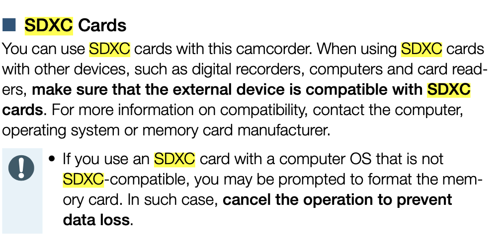

If I then download the user manual, it also says that SDXC cards are supported.
From the Wikipedia link I provided above, SDXC is listed as a min of 32GB and a max of 2TB.
2TB is identical to the "2048 GB" shown in the screenshot above.
The user manual also lists some speed classes for SD, SDHC, and SDXC cards. You should look at those, too.
Rather than relying on a possibly outdated manual, you should download the latest manual and use that.

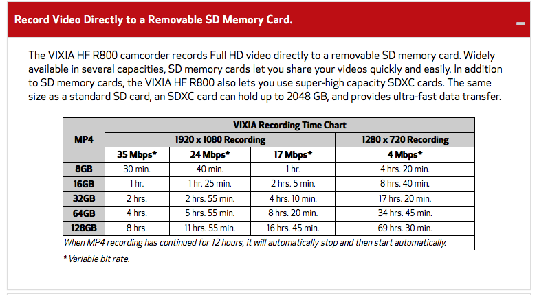

From the Wikipedia link I provided above, SDXC is listed as a min of 32GB and a max of 2TB. 2TB is identical to the "2048 GB" shown in the screenshot above.
Wow I did not know this. I overlooked it. If it will take 2TB then it will take 256GB thank you sir!
The main thing I did was to carefully read the current specs, once you'd identified the exact model.
If the original manual mentions SDXC at all, then it would logically follow that SDXC capacities would work, unless it specifically says otherwise. I have no way of looking in the original manual, so maybe you can check that.
Looking only at the SD/SDHC/SDXC table of min and max capacities on Wikipedia, SDHC tops out at 32GB. That means anything more than 32GB would have to be SDXC, so if 64GB is listed in the original manual, it could only be an SDXC card.
