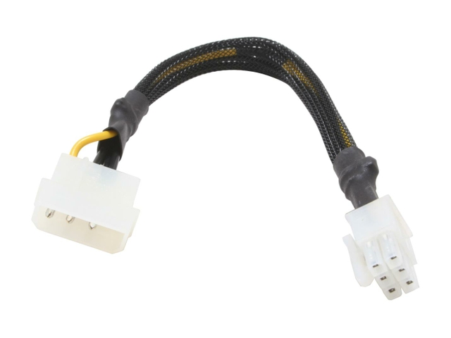

Now, a good video card will need a seperate power lead, this is already taken care of. See, the kind folks at apple thought to include two four pin connectors for Graphics cards. Just find the correct dongle at any computer-centric electronics store, and go to town. Plug the power lead in and you're ready to go. Shore the case up, and make sure that all the cards are properly seated. Did I mention that you should have already installed windows??? It pretty much goes without saying, since anyone interested in this would have already installed boot camp and all.

I spotted the two SIX pin connectors by the fan housing next to the SATA on board connectors. They are unusual. Are those the two you are referring to?
And you found dongles for THAT connector ???

I was drunk when i wrote that, it was quite late, they are 6 pin connectors, I had mobo power on the mind. I can't find a pic online, but I got mine at fry's it's a standard PCI-E Power Cable, so I just assumed any other decent computer store would have it, maybe I'm wrong?

If your half decent with vinyl tape, you can just buy two of the 4-6 pin jobs as they are abundant, strip the right wires and link the two together. I've done that to make custome cables before with my PC.

Well, at this point, you have me beaten. I cannot find this mating connector anywhere. It is not a standard used at all on PCs. It is like a shrunken PCI-E connector, about 2/3 the size of a PCI-E. Tried Fry's -- no go. It is possible it is a standard connector used by Apple.
What is interesting too, is that the conductor size in the connector on the mobo, are very small for high current application like PCI-E for vid-cards. If you get any more clues about where a dongle with connector on it can be found, let me know. Until then, I will snoop around a bit on the net.
Note this site where they go through a disassembly of the Mac Pro with many photos. Some of the photos show these sockets being used, even apparently for the Quadro Apple card's own added DC input.
http://www.powermax.com/articles_reviews/article.php?id=32
So it definitely appears to be an "Apple exclusive" connector type but is used to supply (apparently) DC for vid cards and other items...

It's a standard connector, not necessarily in the world if PCI-E, but I thought the same thing when I first saw it, "WTF?" Then I remembered I had a device that looked not unlike it, that's what compelled me to go to fry's in search of the bounty. Apparently I just got lucky. :-(

Yep, probably made by Molex or some other big connector house -- anyway, I sure am out of sources --- unless I can identify the maker and a part number, then I can build my own cable....until then.... Thanks for trying.
